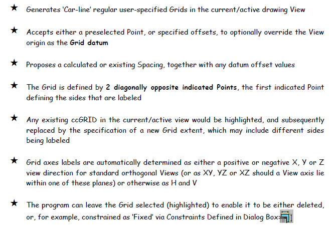

Saw the above referenced thread that mentioned they had a start to a grid macro for CATIA V5 drafting. Is that still available? I'm looking to come up with a macro to accomplish this but don't want to start from scratch if I don't have to.

had a tool that creates body lines in relation to your 3D file absolute axis system. It looks like the site is gone now. I have attached a copy of their tool, unfortunately its encrypted but it works. edit: I don't use this for business since I can't confirm the original developers terms of use.
