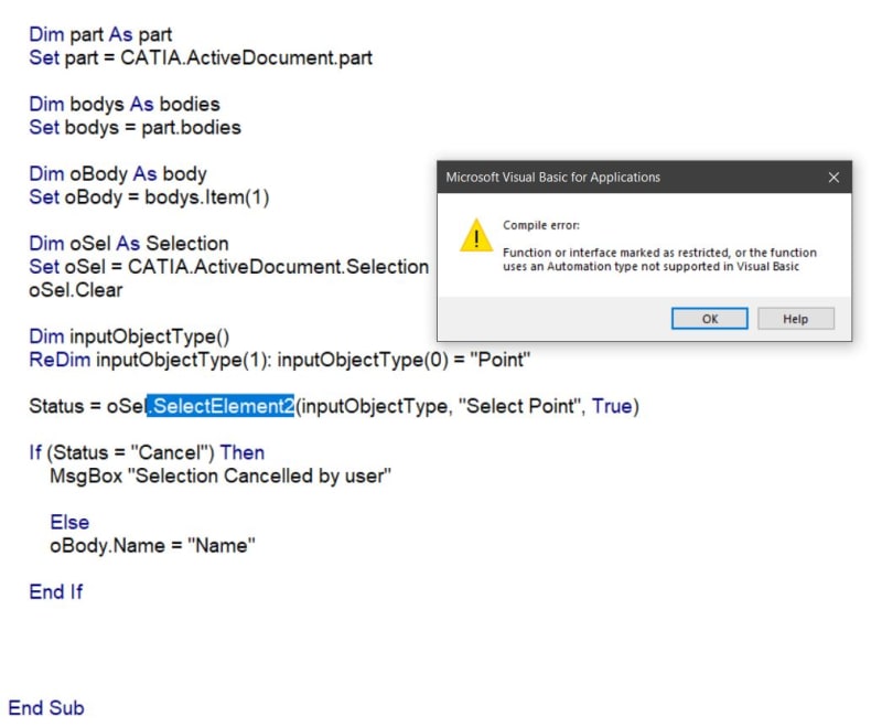

Hello all
i want to create a macro where i can select points lines bodies geoSets and rename them
i tried with this macro but i am getting this error
it looks like selectElement2, 3 doesnt work in VB SCRIPT, they work in catscript but i want to write macro in vb script
how to fix this or is there any other way to create macro to rename elements in catia
The macro must be in VB SCRIPT
here is the Error i am getting
Try late binding
Code:
Dim InputObjectType(2), Status, [COLOR=#EF2929]sel2lb[/color]
  InputObjectType(0) = "BiDimFeatEdge"
  InputObjectType(1) = "TriDimFeatEdge"
  InputObjectType(2) = "HybridShapeCurveExplicit"
  Set sel2lb = Sel2 [COLOR=#73D216]'late bound sel2[/color]
  Status = [COLOR=#EF2929]sel2lb[/color].SelectElement2(InputObjectType(), ">>>>>>>>>>>>>> Select a guide curve <<<<<<<<<<<<<<", False)
  If (Status = "Cancel") Then Exit Sub
