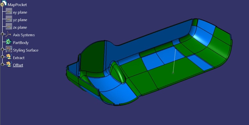

Hi
i wrote a macro to offset multiple surfaces at once and its working fine but the surfaces are not offsetting in one direction instead some surfaces are offsetting inside and some are offsetting outside
Here is the image
Here is the macro script

How to write macro to offset surfaces in only one direction
Here is the image
