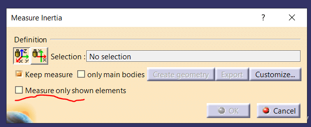

Hello all,
I have created a macro to measure mass of each part in an Assembly(CatProduct).
The macro is exporting BOM of complete assembly as excel file and then using that BOM to get mass of each part present in the assembly.
The macro is working fine but I noticed that it is measuring mass of hidden bodies/elements too.
Can someone help to modify the macro so that it measures only shown elements?

In short, I am searching for how to select "Measure only shown elements" using catvba? as shown in this image:
Thank you for your reply Little Cthulhu.
Selection.VisProperties doesn't solve my issue as there are visible parts having some bodies hiddden.
I want to measure the mass of that part as a whole (but it should not measure the hidden body mass).
there is a setting in tools-options that controls that tick-mark:
General-Parameters and Measure: Measuring Criteria: Measure only shown elements
Once you export settings of this tab, you will be able to deduct how you can toggle it on via script (GetAttr/PutAttr-methods):
Code:
Set settingControllers1 = CATIA.SettingControllers
Set settingRepository1 = settingControllers1.Item("MeasureSettings")
long2 = settingRepository1.GetAttr("MeasureOnlyShownElementsStatus")
' Parameter 1 : (String) "MeasureOnlyShownElementsStatus"
' Returned value : (Variant) (Long) 0
regards,
LWolf
Great, I was looking for this only...
I will modify the macro and test it....
Thank you LWolf!
Yes, It worked for me!
