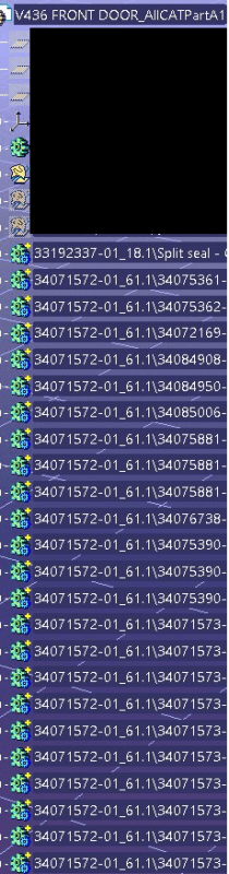

When I generate an allcatpart, I still have many other bodies inside:

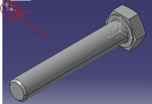

I want all the elements of the open product to become one solid. Like in the picture with the bolt above.
That's not possible I'm afraid. Your best option is Generate Catpart from catproduct.
well, first step would be the Catpart from Catproduct.
Then one could combine all the bodies into one, by adding them to the partbody.
last step would be to copy that boolean-added-full-body and paste it as result to another file...
