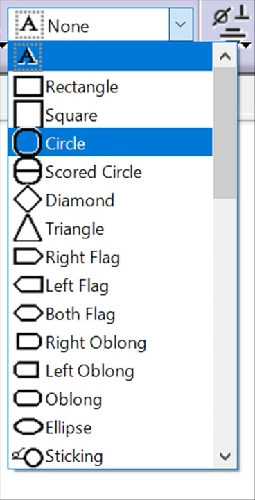

There is a code that opens a msgbox and asks for input text.
It will then search drawing for that text and change it to red.
see thread Link
I had to change a line of this code to be "endPos = Len(InsertText)" for it to work correctly for me.
Look at each line of that code and try to understand what it does.
Once you get that code to work, look to modify code for border of that same text.

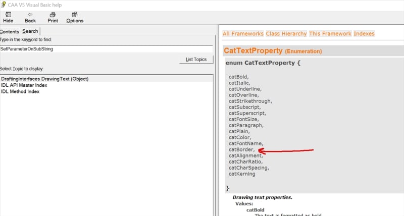

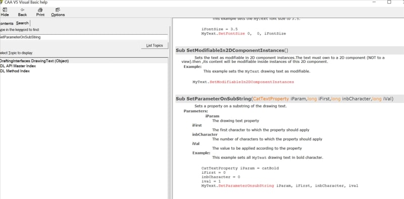

look in the CAA help file (should be installed on your computer)
important for SetParameterOnSubString as this modifies a portion of the complete text.
the value for the circle border will probably be 3 ( the fourth option with No border being zero)

endpos for SetParameterOnSubString should be something like the length of substring on which you want to apply the change...not the position where it ends

I think you need to use the SetParameterOnSubString, like you had on your first version.
and need to then identify start and end positions of the frame.

in order to frame only the regex you need to
[ol 1]
[li]check if it exists (done with regex.Test(CurrentText.Text))
[/li]
[li]then check where it is to define the starting position of the subtring[/li]
please check this post to see how that is done
[li]finally get the length of the regex to define the length of the substring you will modify[/li]
[/ol]
