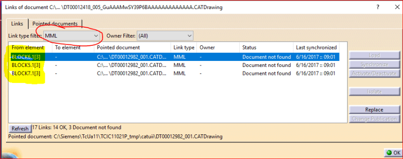

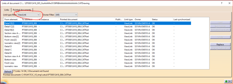

Opening the links in 2D offer three options:
1) (All)
2) MML
3) ViewLink
I can't find ( or I do not know how to find it) the geometrical item from the MML (BLOCKS 6,5 and 7)…..!!!!
Btw, what MML stands for??????…..
Thank you,
CAD 2015
Multi Model Link
your blocks might be in a Detail sheets to be used as a ditto. (100% guess here)
You should be able to search your drawing by name with CTR+F
