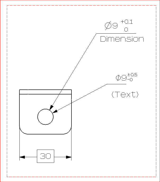

How could I create a tolerance attached to a dimension with +/- 0.5 (upper) and -0 (lower)?
Below is a picture of a text:
In the picture below I couldn't place the "_" sign before the 0 in the dimension.
I made a text as a sample of what I'd like to get!
Thanks!
[bigsmile]
CAD 2015
The purpose of the dual boundary tolerance style is to call out both upper boundary (the top line) and the lower boundary (the bottom line) specifically and independently. The purpose of the +/- tolerance style is to call out the upper boundary and the lower boundary as being the same value and stated on one line. So, to put both styles together, would be a contradictory format. You would be specifying the lower boundary twice. That's why it's not an option to place like in the text you made.
