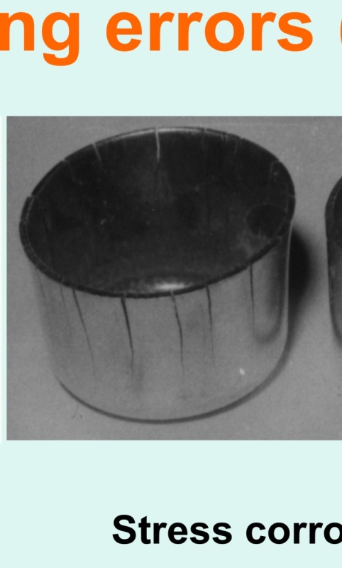

I saw a cooking pot that was made of stainless steel. It was used to cook potato soup. After cooking a restaurant owner decided to soak the pot in hot soapy water over night in the sink. The next day he found the pot literally cracked up like a banana peel! I have attached a photo. What failure mechanism would cause such a spectacular failure of a cooking pot?

The discussion has gone around forming operations and SCC. But seriously, where was the tensile stress that caused SCC? Residual stresses at the time of forming has caused CSCC...wow!

It does not take much stress. I have the example of an oven used in a pharmaceutical process made from flat 304 sheet where the cleaning agent used contained chlorides and was not thoroughly rinsed. That cracked cracked completely throughout.
Yes, and the magnitude in this case is more than sufficient to provide one of the three prerequisite conditions for SCC.
p.s., at the right (i.e. wrong) temperature and with a susceptible austenitic stainless steel, chloride SCC has been observed with Cl- concentration in the ppm range.

I would assume such a pot would be cold drawn from annealled sheet. Why would it sensitize?
My bet is on SCC. Plenty of residual stresses, plenty of chloride, plenty of oxygen.

Would we really expect a component with residual stress from deep drawing to have cracks ONLY in the axial and none in the radial direction? And no cracks on the rolled lip either, except through the lip?
Would we also expect the cracking to happen when the object was sitting around in a presumably cold soap solution?
Agree that the conditions for chloride SCC are all there- heat, stress, oxygen, chloride and stagnant conditions. But those conditions are encountered in all cookware- perhaps the exposure duration of this component, being used in a restaurant, was long enough for pits to start- from what I've read, pit initiation is necessary before Cl SCC can start.
Better photographs would be needed for the people (unlike me!) competent in failure analysis to do more than just guess about it. There's a burr on one edge of one of the cracks that makes it look rather like a sawcut- that and the regularity of the distance between the cracks looks a little suspicious. I'm sure the owner could tell the difference between a sawcut and a crack, but it's impossible to tell from this photo.
Yes we would expect cracking that that direction, because the stresses are much higher in the hoop than in longitudinal.
Mu hunch is that the rim is usually dry, in use any liquid there would evaporate. But this was being soaked and there could have been fluid there. Combined with the hot water in a restaurant being 185F I could see this finally happening.
I have never seen a pot crack while cooking, but while soaking and cleaning it isn't unheard of.

It’s SCC failure where the strees comes mainly as residual from the fabrication (and use, of course) due to a deep drawing deffect like wrinkles or microscopical scratches. Thermal cycles in cooking, chlorides in the food and soap contrbuted to the mechanism.
It appears to be case closed, based on the reports of high residual stress from deep drawing, and propagated cracks appearing to run parallel to axis, not hoop.
