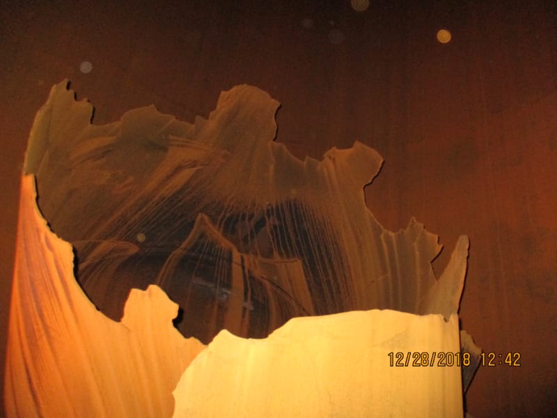

We have an application with a water seal that has a 1/4" thick x 40" diameter pipe supporting a large pipe 64" cap and 64" pipe segment to form a water seal. I suspect the 64" cap and 64" pipe segment is vibrating/moving on top of the 40" pipe due to flow and there was a failure of the 40" pipe. The attached photos shows the failure of the 40" pipe. Is the jagged nature of this failure indicative of a back and forth motion which produces this jagged torn appearance? The "top hat" or pipe cap assembly was torn from the 40" pipe. I am more interested as to the mechanism of this failure type (jagged torn appearance).

What are all those strange lines / striations?
Looks like brittle failure of some sort, but not really a lot of data here.

Got my suspicions, but everyone is right that you need an actual failure analysis performed at a lab. I wonder how thick was the fracture compared with the general pipe thickness?
The 6.35 mm thick pipe / plate has seems to have become paper thin!
