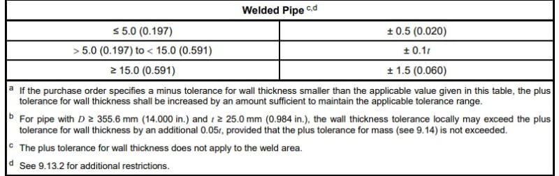

I am currently dealing with SAWL 36 x .750 wall API 5L x52 pipe. I am being asked to prove that the + or - 12.5% wall thickness tolerance is in play for this SAWL size pipe.
Keeping in mind that LSAW cannot carry an ASME nor an ASTM monogram, where can I find in API 5L 46th Ed. the wall thickness TOL.?
The general wall Tolerance for welded pipe >.591 wall is +-1.5 (.060) Annex J and annex N clearly state that welded pipe over 14" .984 wall are +-12.5%

Wall thickness tolerances are given in Table 11. For welded pipe they are tighter than 12.5%.

I don’t want to come across as uneducated but in the case where API stated:
What would the + or - tolerance equate to on .750 wall??? What is the formula. As far as I know it doesn’t carry the “t” designation. I believe all it says is milimeter.

Correct.
Above 15mm, the tolerance goes to a fixed thickness + or - , not a formula.
So your tolerance is 1.5mm
