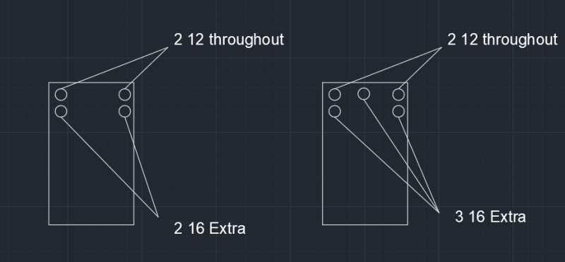

can we provide beam reinforcement like this? 3

You can, if you want to confuse the barsetters. Best just to stick with one size, especially with small bar sizes. M16 is my minimum size for beam reinforcement.
Can we provide extra bar of higher diameter than main bars ?
I thought my answer was sufficient. The bars don't know which ones are 'main' and which ones are 'extra'.
You can, but why not use the one bar size?
Eg 4 N16.
N16 isn’t an especially big bar. Like hokie66 it’s the smallest bar I’d consider in a structural beam.
I agree with hokie. In theory yes, but good luck getting this installed correctly.
Corner bars are typically what hold the stirrups in place until everything is tied as a cage. The minimum size with sufficient stiffness to accomplish that is typically 15M. Even if you drew the beam the way you have, and I caught the distinction, I'd still put 15M instead of what you've drawn because I'd need it that way just for constructability purposes.
BTW I am unfamiliar with the sizes you're specifying. What part of the world are you? In Canada, we order in metric but I've never heard of a 12M or a 16M bar. We have 10M and 15M and as far as I know generally go in increments of 5. Found this table and it looks like our European counterparts have oodles of sizes. Wowzer!
How large is the beam? I assume you are reinforcing the bottom only? As drawn, the only bars I see are on top and that's not how you reinforce the beam.

this is the output I got from etabs ,
so , 2 12mm dia bar throughout which is 226mm2 which is more than 155mm2
Since we need more rebar at support (near column up to 0.3L/0.25L)
I provided 2 16mm extra bar near support so total reinforcement of 628mm2 near support which is more than 550.

EDIT: OP, you could use 2D14 at midspan and 4D14 at edges or 2D12 and 5D12 if the beam is wide enough... or 2D16 and 3D16.

Haven't seen anything to validate it, but my suspicion is that when the beam stirrups are 6 and 8mm, developing them around a 10mm or 12mm corner bar works just fine.
