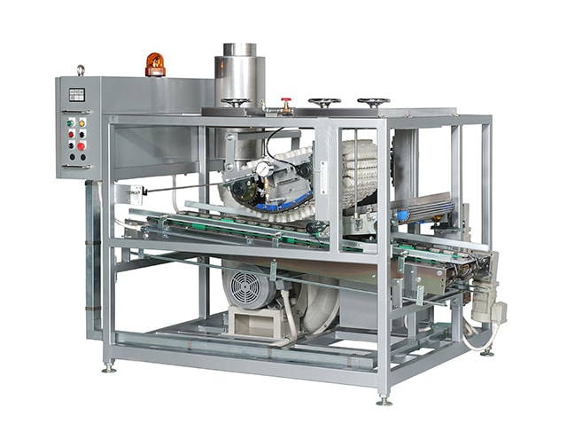

This sort of reminds me of where I worked when I first graduated fro engineering school. We had developed this machine which used a significant number of a particular item which was expendable, that is, they would wear out. It was what was called a 'depanner', for taking bread and rolls out of baking pans in large commercial bakeries:

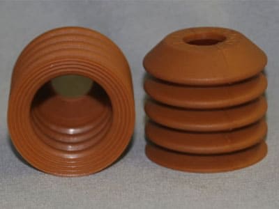

Now we were one of three or four companies who made these machines and they all used basically the same type of silicon rubber 'vacuum cup':
Now the issue was that the company I worked for held the patent for using 'vacuum cups to lift food products'. And since this was, as I said, an expendable item which had to be replaced often (over the course of year, a typical high-production facility would go through four or five sets of cups per machine). Now they weren't that expensive and they became basically a commodity, that is no matter who you brought them from, they were identical. Now we didn't manufacture the cups themselves, that wasn't what we did. And since these cups could actually be used for applications that did not involve picking up a 'food product', we actually had no claim to the cups themselves, just how they were used. Of course, when we sold one of our depanners, no big deal because it was our patent, but if one of our competitors sold one of their depanners, we collected a royalty of $200 (note that this was back in the 60's and 70's). And it wasn't just depanners, as there were a couple of companies, for example, that made machines that picked-up eggs and placed them in those paper mache cartons, at least they were paper mache back then. But since eggs were 'food products', we collected royalties from them as well. Whenever there was a trade show where machinery was on display for use in any sort of food production or processing industry, we would always send one of our people with a copy of our patent and some blank contracts. Every once in awhile, a new 'customer' would show-up.
And then there was the spares business, and since, as I said, all the cups were the same, we also made money selling replacement cups to these large bakeries whether they had one of our depanners or one from one of our competitors. Anyway, it was a sweet business, but of course, that was over 40 years ago, so I assume that the patents have expired by now.
