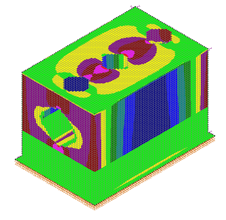

What I do is model the wall sections as a series of FEA 2D plates, apply loads to the plates, cut out openings, and analyze the model to get shear and flexure in the structure. I generally conservatively design for the highest forces in the structure for shear and positive/negative flexure. Keeps the rebar nice and easy for the contractor.
When you get into complicated opening conditions (bunch of small openings clustered) this is really the best way to go. Last I checked the numbers you get from a FEA model are roughly the same as from PCA Rectangular Concrete Tanks text. If I recall, a FEA analysis was how they developed their tables.

Example of modeling (showing horizontal flexure):
FYI: The reason for the change in flexure in the walls is the upper barrel section has a horizontal joint between it and the lower section. The lower section is cast monolythically with the base slab, thus it's primarially undergoing flexure in the vertical direction.
Good luck analyzing this by hand.
