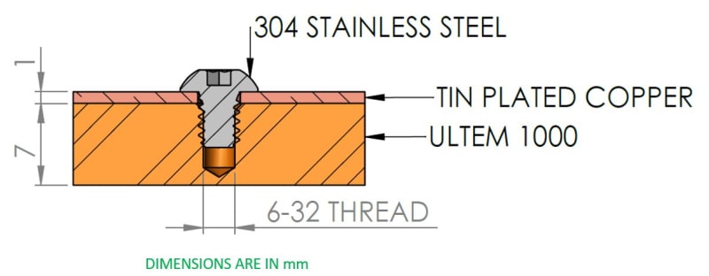

Hello everyone,
I guess you all know the familiar formulas for calculating stiffnesses of the bolt and the members in a classic bolted joint. Classic = when all the components (bolt and members) are made of metals (aluminum, steel etc.).
But it becomes complicated in my case - a bolted joint in which the bolt is made of stainless steel and the members are made of plastic (Ultem 1000).
I found out that using the classical formulas (look at the attached file) for calculating the stiffness of the members lead to incorrect results.
Your help will be blessed.

What is your joint configuration? Please show pictures.
hey,
I am first going to attach a simplified picture of the bolted joint.

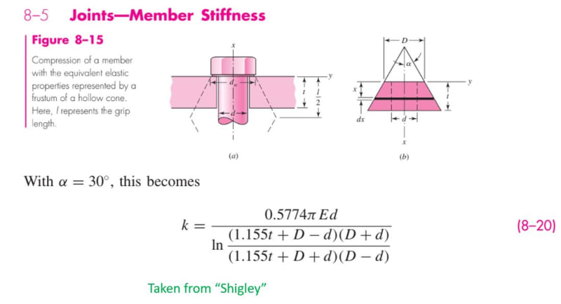

Now, please see the equations I used for classical calculations:
Finally, I am attaching now a link to an article which has also a formula we used to use with metals:
Using the equation leads to wrong results when comparing it to analysis (FEA) made by an expert who works with me.
Ok, thats a lot clearer.
The classical equations do not apply in your case. They are for thru bolts clamping two sheets; in your case one sheet has a tapped hole. Also, the plastic tapped part likely has a nonlinear stress-strain response, complicating the clamp up stiffness.

Just going by a quick glance at your picture and attachment, I can add a bit more. With your example being a threaded blind hole, the k value will be different to that for a through hole with a bolt and nut. Going by memory, there’s just one cone emanating from the underside of the bolt head/washer, finishing at half way along the thread length. The finishing length could be influenced by the thread axial load distribution. The finishing length may be slightly less than half way along the engaged thread length. Hope this helps.
Shigley's book covers also my case above (a lower member which is threded and not drilled), and not only the case of through hole and a nut.
The difference is the existence of Ultem 1000 as one of the clamped members.

Perhaps using the appropriate Shigley diagram would help. The attached paper is also for a condition you don't have.
Each point on the thread exerts pressure towards the interface; that is the direction the cone of displacement will point.
