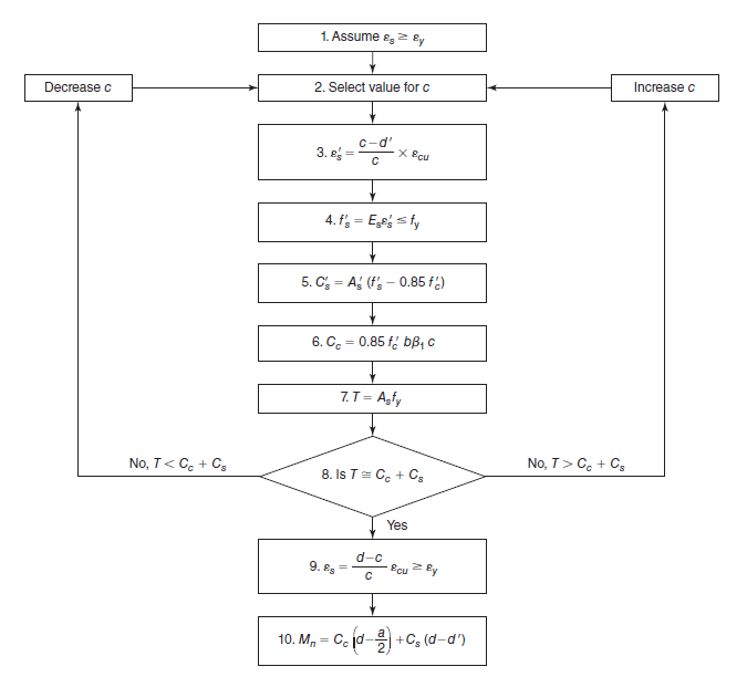

In Wight's textbook(attached below), presented an iteration method. In which the final answer from this method won't be exact, unless the stepping size is infinitesimally small. Whether the compression steel is yielded or not, it will be determined and accounted during this process, but still, the final answer won't be exact.
Instead of using this method, would it be better to just solve for the neutral axis directly from the equation?
Assuming tension steel is yielded.

Implementing the sudo code from Wright requires you to pick an appropriate method to "increase or decrease" c you can do a constant step size but included a conditional to half the step if within a certain tolerance. Really you are looking for a root to the equation 0=T+Cc+Cs where T,Cc,Cs are functions of c. There are various methods to go about finding that root for a concrete beam the problem domain is very well defined and a solution, if one exists, for the neutral axis is within a range of c=0 to c=1.85*H (if using the whitney block), some methods include Bisection Method, Regula Falsi, Newtons Method, Secant Method, Brent's Method.
Your derived exact formula would only hold true for a rectangular section with a singular layer of top and bottom reinf. where the sudo code presented by Wright could be expanded to cover more general cases.
User IDS has some spreadsheet that I believe use Brent's Method: Link
I've got a sheet that does Bisection, Newton Raphson, A Method outlined by Davister in a paper on computer aided design of concrete cross sections, and Brent's Method: Link
All of these methods will be limited to machine tolerance though so may never actual yield 0 but some very small value or pre-determined tolerance deemed close enough the real root.
Edit: I should mention IDS does have a paper where they do derive a closed form solution for the neutral axis depth slicing the section into trapezoids so it is possible.

Note that iterative solutions such as Newton's or Brent's methods can be set to converge to any precision you want, subject to machine precision, and the highest precision is 12-13 orders of magnitude more than anything achievable in practice (given unknowns such as the actual Young's Modulus and yield stress and strain of the concrete, and the actual precise position of the reinforcement).
Having said that, the basic closed form solution is fairly simple, even when applied axial load is included, and can be extended to cover almost all sections used in practice, including multiple layers of reinforcement, and any cross section divided into trapezoidal layers. Most of my spreadsheets actually use a closed form solution, and derivation of the formulas for the more complex cases can be found at:
and
The first link above is the last of a 6 post series, also looking at sections within the elastic range, starting at:
Sections where the closed form solution is not so easily used include:
- Use of non-rectangular stress blocks, especially those with non-integer exponents over the "parabolic" range, as specified in Eurocode 2 for high strength concrete. However note that for a rectangular section a parabolic-linear stress block can be converted to a rectangular block, that will give exactly the same results.
- For circular sections it is much easier to specify the shape as a single radius, rather than splitting it into multiple trapezoidal layers, and an iterative solution using the exact area for a circular segment will give a more precise result that the closed form solution using a circle approximated with multiple trapezoidal layers.
Finally, for the case in the original post including compression reinforcement, for greater precision deduct the concrete stress from the steel stress in the compression zone (because the steel is displacing the concrete). Formulas with that correction are given in the paper linked in the second link above.

But just about every college textbook suggests an iterative solution, which really isn't necessary in most cases.

To be fair to college textbooks everywhere, the ones I checked do give the quadratic solution to the ULS bending capacity with rectangular stress block and rectangular section (although they also give the iterative method and more simplified approximate methods).
It is the linear elastic analysis with combined bending and axial load where the closed form solution requires a cubic equation that is invariably solved with an iterative method.
I still think it makes sense to use the closed form solution when doing a computer analysis (with any number of rows of reinforcement), but I agree there is nothing wrong with an iterative solution.

However in this case, since the proposed arithmetic method is both quicker and simpler than iteration, a closer analogy would be trimming paper with a guillotine, rather than a pair of scissors.
You can do an OK job with a pair of scissors, but if you have a guillotine handy it will be easier and quicker, and incidentally give a more precise result.
And if you have to cut hundreds of sheets, there is no argument which is better.
