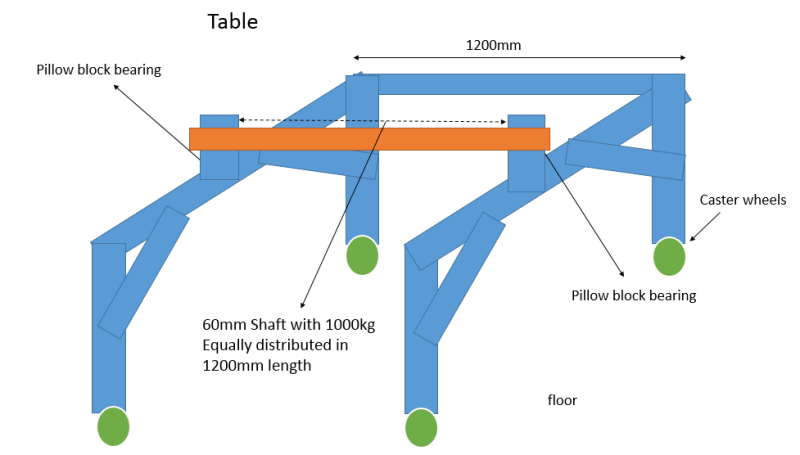

HI Guys!
I just wanted to know how to calculate the stress and deflection of a frame shown below.
Thank you for the help. Cant sleep because of this.

Actually Im trying to make some calculations for the design below. It is a frame with caster wheels, as shown below.
im trying to see how this 45 angle supports will help in the reduce deflection of the beam at load and I need to show it using calculations. The bearing pillow blocks are in the center.
I hope you can help me guys on this.

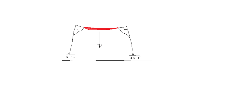

Hi Greg!
Thanks for your feedback. I guess Im just going to make some calculations on the center (in the red portion you highlighted) with a safety factor of 3. I think it will be a good start for the calculation.
Thank you very much.
actually I think looking at just the central span will mislead you. If deflections are critical to you then you need to consider the whole structure.
I would consider the basic frame as a portal frame, with the welds in the corners transferring the moment (two pairs of parallel welds in shear). This would design the welds.
If the welds are not sufficient, or if the deflections are not acceptable, then add the 45deg members, which will make the corner much more rigid.

I would take the angled corner supports and get them under the pillow blocks and then angle them down to the bottom of the vertical leg. Then connect all the vertical legs together with the section you are using horizontally, so in effect all the castors at the base have a rectangular frame around them
Hi rb1957! Ya normally I do that, its just that I want to show in calculation how these 45 braces help in reducing the deflection. Mmmm, well I guess as long as the deflection calculation without the 45 brace is acceptable then should be all good, the 45 braces will be there just for added support.
Hi desertfox! thanks for the suggestion but that would not be possible because i need to slide something on the bottom and it is a space for that.

When and how fast is the Ø 60 mm shaft going to rotate?
Will there be a belt drive or something causing the rotation?
Hi Greg, I will not be using 303 now sorry about that. Ya 304 or 316 will be the material.
Hi T moose, rotation is very seldom, the load is only around 100kg when need to rotate and it will be very slow probably 15 sec/rotation.
rotation will be manual using a gearbox directly mounted to the shaft.

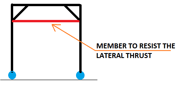

From structure point of view, in your case the contribution from knee braces will not amount to much since the base supports are roller and will simply displace if knee brace take any load. Knee brace will be more effective in reducing the beam deflection if there is a load path to take up the lateral load from the knee brace, such as the frame described by desertfox or the one below.
