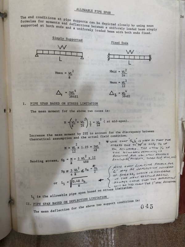

The equation you show is for a simply supported beam where deflection is:
Delta = 5WL4/384EI and when you rearrange you get your eqution with W in pounds per inch and L is in inches.
It is all a matter of what state you consider the ends are. As 1503-44 indicates for a fixed end beam the equation for deflection is:
Delta = WL4/384EI so you get 1/5th the deflection of a simply supported beam.
I have a manual from a piping stress analysis seminar at LSU university that recommended using a value of 1/2 the difference between the values of fixed and simply supported which is:
Delta = 3WL4/384EI
It is just a matter of how the codes calculate the deflection. Note that a deflection of 0.1 does appear too small.
Here is a copy of the LSU seminar notes regarding pipe spans and point loading at supports:
Exactly. 128 <> 384
128 going to look a lot like M=WL^2/10 on a stress based equation.
