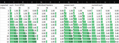

Thanks for your patience Gr8blu. I'm still not getting it. To be clear, I am assuming your 'kw' and 'kW' is the power magnitude - no phase info.
For my learning purposes I have normalized everything to one: 1V, 1A → 1W. In the simplest case of just one heater, your calculation results in phase currents of 0.58 A, when it should be 1. Then for more heaters, the calculation does not match what I have gather from SPICE simulations.
Columns C-E show the SPICE results as a reference. N-P show individual heater currents. Q-S is the sum for each phase (power = current here). And T-V is the final current calculation, which is simply columns Q-S divided by sqrt3.
What am I missing?
Thanks again!
