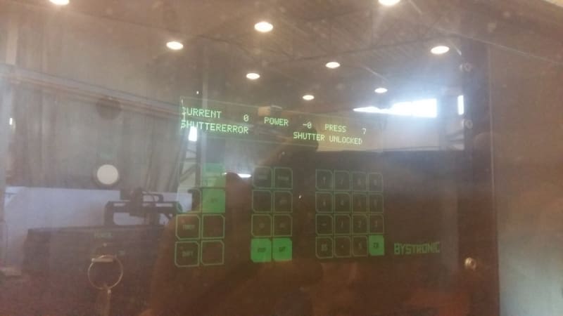

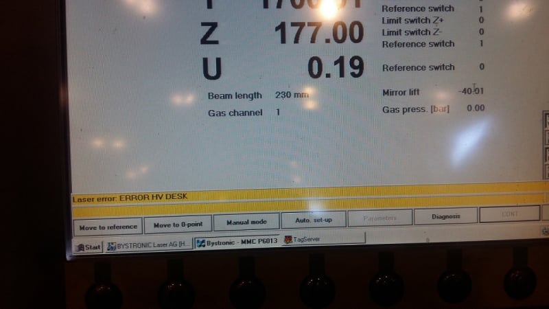

Hello,
I have a problem with this Bystar 3015 (2004 year). Computer shows Error HV desk and HV cabinet display shows shuttererror. I try to send head very many times to reference and 0 point, changing tables, resetting. I opened resonator cabinet and cleaning shutter. Everything was ok there. I dont know, dont have any idea what try next.
theres a switch and a few contactors in the shutter safety circuit. just need to get out the schematic and trace it out.
