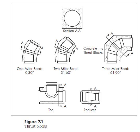

I would like to share my past experience for the GRP PIPE;
-The use of thrust blocks is a must for UG installation if the couplings are REKA coupling without straining..
-If the joints locked ( axial thrust restraining ) and if in case of high sustained internal pressure , still the use of TB is the best option
- The bends normally encased in thrust blocks and if necessary , provide short pieces at both sides,
The following figure is the concept for the TB for bends,
- AWWA Manual M5 Fiberglass Pipe Design adresses the use of TB at section 7.
- the following GRP installation guide is useful..
Yes. Those full encasement blocks are good. I would avoid one-sided point bearing block type.

You are making the case not to buy Flowtite pipe, instead of the need for thrust blocks. The practicality of installing encased thrust blocks will make the use of Flowtite pipe uneconomical.
Ameron, another supplier of FRP pipe states:
"No thrust blocks are required at rated system pressure for most buried piping configurations and most soil conditions."
As stated by LI, "Any more details? - Size, pressure, temperature, pipe thickness, water hammer, soil loading, that sort of thing."

I am retired engineer for several years after 40++ active working life and do not have any relation with any manufacturer..If you are still active, try GRP pipe loop ( Bondstrand, AMeron ,etc ..) with mechanical locked joints , without TB's and the bends fabricated miter bend , the sustained pressure is more than say 10-15 bars, dia 20 in or greater..when the bends start to fail , excavate bend locations, change the bends with new ones with TB ,

Second, the use of thrust blocks on underground GRE piping is not appropriate for systems subject to thermal expansion. They may be needed to resist pressure loadings on the joints and keep the system together, but they do not solve thermal expansion issues

Just add expansion cushions. Usually it reduce stresses a lot. See paragraph 4.1 here If not help, then add U-shape expansion loop
I think thrust blocks is not good idea. Expensive and unnecessary.

In my experience, for fully constrained buried GRE/GRP systems using TB/TS or lamination joints, thrust blocks are not required. The high stresses at the changes in direction are dealt with by providing additional thickness by way of overlay lamination to provide reinforcement.
