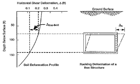

The picture depicts soil deformation vs depth from (NCHRP ,Seismic Analysis and Design of Retaining Walls, Buried
Structures )
This document is useful to see the soil -str. interaction, backstay effects
