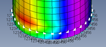

I know this question has been asked a few times. I'm sure I checked almost every answer avaiable around. But I'm still having trouble using SOL 105 buckling with inertial relief.
Here's the .nas/.dat Nastran file: https://drive.google.com/file/d/1RrH_hMMeLpE3qEWH_Ea3nuVQBoBBindj/view?usp=drivesdk
Here's the error I'm having in the buckling set, from the f06 file:
I have INREL set to -1 in the Bulk Data:
I also have SUPORT1 defined in the Bulk Data:
And finally I'm running a STATIC SUBCASE with SUPORT1 and then calling it via STATSUB in another SUBCASE for buckling.
What am I doing wrong?
Photos of the setup.
1751574957000-png.14826

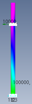

The model is a LAMINATE composite tube with two RBE3, each with a load in the center node. I put the SUPORT1 constraint in a random node restricting 123456 dofs, just for test.

Just a guess: Does your SUPORT1 node have the ability to take moments? The 456 on the support card basically require that point to have that ability.
Does your model have solid elements? Is the SUPORT1 node attached to only solid elements? That might be the problem. Solid elements cannot take concentrated moments., and you cannot support a rigid body about a point that cannot take moments.
I believe the SUPORT card allows you to apply rigid body restraints at different nodes, for example: restrain DOF=123 at one node, DOF=23 at another, and DOF=3 at a third (not all one a line). Then those 6 translational restraints serve to provide rigid body support in all 6 DOFs.
