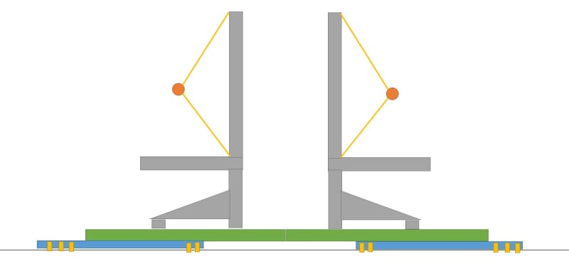

FEA way - I would love to post the model but unfortunately our company policy are quite restrictive on it. Essentially its a interfacing structure for a pair of seats, which secures into a helicopter floor. The interfacing structure consist of heavily machine Ally plate, with 'pockets' etc. It has multiple interfacing brackets, seat rails and a lot of fasteners (as you can guess).
- I'm using simple beam elements and couplings to transfer load between the parts, with preload applied in the middle of the beam.
- The model contains Surface-to-Surface contact between bodies.
- Boundary conditions are fasteners into the aircraft floor (the floor is not modelled), however in the image below it would be the yellow items. The Beam element is restrained in all 6 DOF at the shear plane of the model and the 'floor'.
- My 'Occupants' are modelled as Point Mass Elements, and is secured into the seat using Distributive Coupling elements as shown (representing the harness).
Currently my low buckling values are occurring in the green structures (two of them and not quite symmetrical), which is expected but the low eigenvalues are concerning.

you are not likely to find anything useful in the FEM documentation. it is up to you to understand and use "dead" and "live" loads; suggest looking at classical buckling texts. in this case I would ignore the whole "dead" loads thing and just consider all of your applied loads to be "live", to which the eigenvalue is applied.
but presumably you are sizing this structure for downward crash loads. with that and given the configuration I highly doubt you have a classical eigenvalue buckling case. rather you likely have a large displacement, high stress (beyond yield), etc case, which will likely require a nonlinear FE analysis for adequate analysis (nonlinear material and geometry - the whole ball of fun ....). and a lot of the energy absorption is going to come from fastener hole bearing deformation and fastener failure modes.
