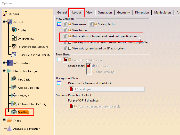

When I project a broken view, the projected view isn't broken to match the parent view, and if I break the projected view the breaks don't line up. How can I align the views or how do you create a broken projected view?
You have to check this option before generate the views
Regards
Marc
