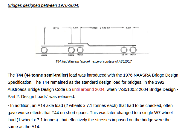

A series of bridges in a developing country are rated at T44 (42.5 tonnes) I want to drive a total of 80t across the bridge. How many axles do I need or is it impossible?

It's a complicated problem. We simplify things by load posting bridges for a certain tonnage but it says nothing about the axle spacing. Bridges are typically posted in the US for what is known as Legal Loads. This group of trucks have their own axle spacing and load distribution. What you are talking about sounds more like an overweight Permit truck. You can typically put more weight on a bridge for a permit truck than for a Legal truck because you can play with the axle spacing, speed of the truck, and possibly provide traffic control on the bridge to ensure that only the Permit truck is present at the time of crossing. However, the only way that you are going to know whether or not you can cross is to apply for an overweight permit for your truck. Whoever owns/regulates the bridge should be able to check this. The permit application sometimes covers their expenses. Another way may be to hire a local structural engineer who specializes in bridge design to check it and submit supporting calculations as evidence that it will pass. Being in a developing country, it may unfortunately may be more difficult to get your permit.
The 42.5 T rating doesn't say much. It could be the equivalent of the AASHTO Inventory Rating or the Operating Rating. It could be some sort permit vehicle.
It could be a somewhat iterative process to arrive at an answer. Are you the trucker who is shipping this thing? Does this fit on a trailer or do you need dolleys? Once you have a scheme for shipping the load, analyzing the girder is easy. You can adjust your load factors if the truck will be the only one on the bridge. If the analysis shows the girder can't support the initial axle road, look at a different trailer with more axles and repeat the analysis.

I think StrctPono has the most direct answer --
You'll either have to ask the government body responsible for the bridge and/or hire an experienced local bridge engineer to check for you. (Experienced because it's not a straightforward problem to solve efficiently, local because they'll likely need to inspect the bridge). 42.5t to 80t is quite the stretch, but depending on the bridge and methods allowed, not impossible.
