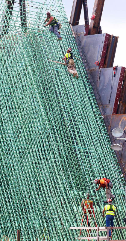

Sorry guys, I wan't really suggesting that this failed first or that a lack of rebar was to blame, I'm just used to seeing something more like this:

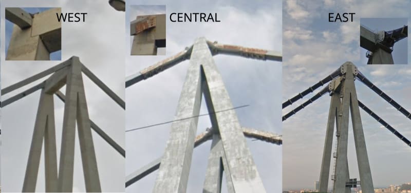

This is from google map. The west tower which collapsed was not properly reinforced so far as I understood.
My text got cut off. Article on a study to look at the stays. So, they had already retrofitted the east span stays, had a report stating there was an "anomaly" in the subject span, and were working on a fix of some sort apparently. This is looking FIUish to some extent.
In the case of the Genoa bridge, Occhiuzzi noted, some of the stays have been modified with clearly visible reinforcement, but the collapsed section was not modified. It is necessary to understand the background of the decision to reinforce some stays, but the same treatments have not been carried out on the other stays that are similar.
[URL unfurl="true"]http://www.ilsecoloxix.it/p/mondo/2018/08/15/ADxP1VAB-problemi_morandi_precedente.shtml[/url]
