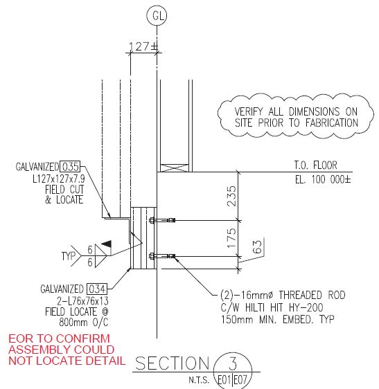

Most jobs I see have the brick supported on a shelf angle welded to the slab edge angle.

@XR250 I always felt weird about that. I could attach a relieving angle to the pour stop, but I'm not sure how strong it would be. I'd probably weld some rebar into it as well to connect it to the slab. I've always connected it to the structural steel beams themselves because I'm sure those are strong.
Shelf angles can work but they should have vertically slotted holes to allow for adjustability. You don't know with any degree of certainty whether the angle will coincide with a mortar joint. Another issue that arises from this is who adjusts the angles? The mason? the steel erector? Architects hate them because of the thermal bridge they can create via the anchors attaching them to the superstructure. (I question this concern by reasoning how much energy is actually being lost through a 1/2" diameter anchor, but thats just me).
This detail is often used, or variants of it. The support angle often has the leg up. The clip angles are generally half as long and spacing varies from 30" to 48", generally.

Having an angle continuously in contact with a concrete wall or gradebeam does result in heat loss. Heat readily flows from the 'hot' gradebeam' the the excellent conducting metal angle.
I generally limit the length of the shelf angle to 20' or so due to thermal expansion (It's cool in Winnipeg in January). With a clip support at the ends of the Ls, I don't worry about the 1/4" gap I spec, and I really don't care where it falls on the mortar joint or brick. [pipe]
