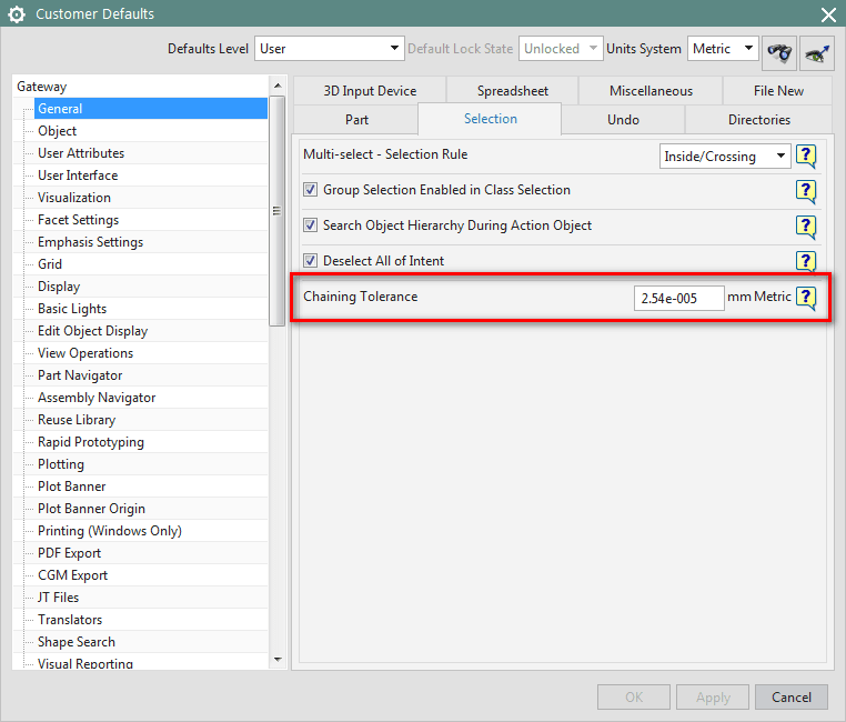

Hello,
I'm trying to create a break line view boundary using sketch curves. I keep getting a message saying "The selected curve is shorter than the allowed chaining tolerance." Why am I getting this message? Can I change the chaining tolerance?
Regard,
Loka
You can change that in the Customer defaults.
But most probably there is a tiny element in your sketch. Did you create the sketch from imported curves?
You can use the Examine Geometry to check for tiny objects.
Tiny elements could also be created during trim actions in the sketcher.
