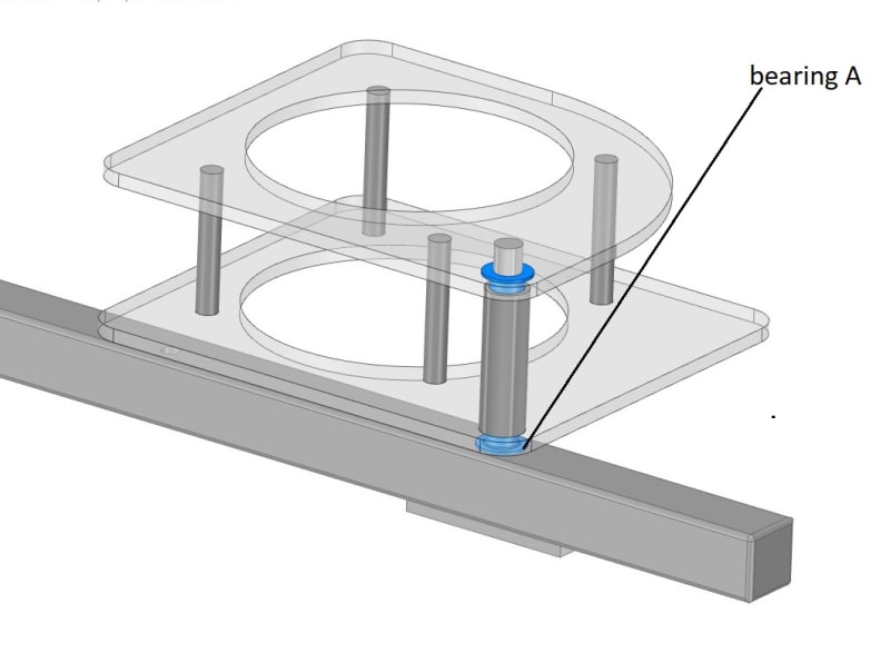

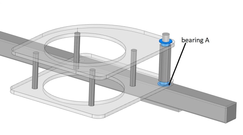

Hi everyone, first time post & first time on the forum - (Im not a mech. eng.)
I need a bit of help with a bracket design....
The images below show a bracket which will support a camera to inspect parts on a production machine. The bracket assembly needs to pivot about bearing A.
The total estimated weight of the bracket assembly is about 2.4kg .(uniform dist.)
The concern I have is that the bracket assembly will droop or tilt about the bearing A pivot point due to the weight and small support area of bearing A.
-Ive considered the following ;
a) larger flange bearing to provide better support
b) tight tolerances to reduce any sag or slack in the hinge

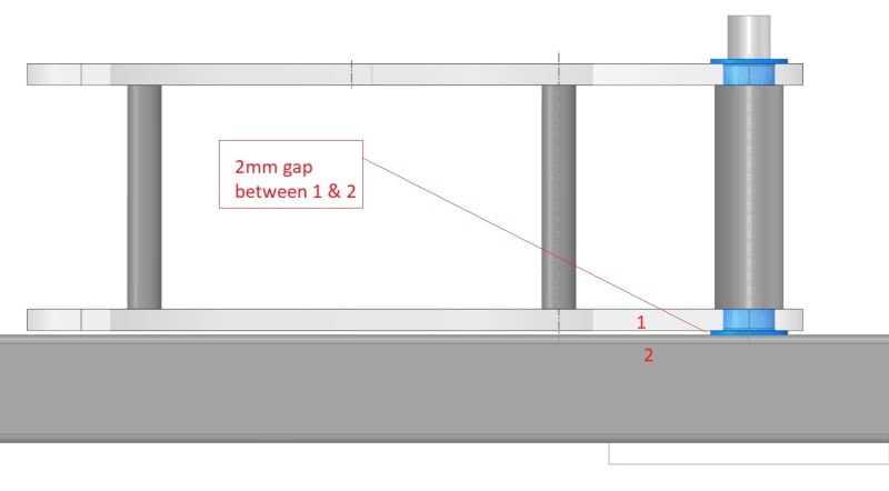

c) increase flange thickness on bearing A to increase the distance between parts 1 & 2 (image 3)
Could anyone offer any other ideas regarding the bearing and pivot point.
Its going in a food production environment and we cant use normal ball bearings

Well, if your assembly sags, there are several possible reasons:
1. Play in the hinge. Use an appropriate fit between a shaft and a hole and/or have a larger area at the bearing.
2. Stiffness of the hinge shaft. Choose either thicker hinge or a stiffer material.
3. Stiffness of the structure as a whole. Adding triangles helps.
4. Stiffness of the individual parts of the structure. Use a stiffer material or increase thickness.
Or provide a support on the rectangular beam so the far end of the bracket slides on top of it. That way you don't care about the amount of sag under load.
Those are all the options as far as I see.
How much deflection ( angular and linear ) can your camera handle and still be expected to inspect the parts properly and reliably ?
As long as the bracket doesn't bottom out then wouldn't the deflection always be the same? Unless you changed to a different camera I guess. But if there are dynamics involved the camera may shake up and down through any backlash.
My experience with non-preloaded bearings in applications like this is that there will always be some slop. You might be able to get a tight fit in the beginning but repeated movement would probably create some looseness.
I'm guessing the bearings are plastic (for food handling)?
Do you need 360deg rotation? Can you have a brace that comes from the bottom bar to help anchor the top of the shaft?
I would do two things.
Make the bottom shaft mount permanent, welded. Don't use fasteners and risk them working loose.
Mage the shaft as large diameter as possible and make the lower bearing larger, as big as you have space.
Using the flanged bushings as bearings will work, but you will need to make them a little snug to minimize play.
What are some of the dimensions? 2.4kgs is relatively light weight. I would expect more error from the shafting being not normal to the surface than error generated by the deflection from 2.4kgs. But without any dimensions that cannot be said for sure. Off eyeball-o-meter if the washer is 2mm then the shaft looks to be 12mm~. Is the deflection significant enough to matter?
Simple solutions; Add a nut on top of the shaft. Preloading the bearings should help. Ed is right though regarding the working loose of the nut. Consider a system to hold the nut (jam nuts, wires, tacking, etc.)
More complicated but still simple; Determine the bending the camera & mount system puts on the shaft. Add a counterweight to the opposite side.
You might be misunderstanding the bearing loading. As long as the camera mount assembly itself is relatively rigid then the loading on the bearings is simple, and all the load is transferred directly to the pivot shaft. The thrust bearing on the bottom sees no moment load, just pure linear force. You should consider lengthening the fixed shaft to go through the bottom of your square tube. This will give it stiff support. Then all the moment created by the load on the bracket is absorbed by the shaft as a bending moment. See the image.

Angular contact bearings are a wonderful tool for high speed, high precision spindles. That is not what you have here. What you have here is basically a hinge, a reciprocating pivot. The type of bearing used here will have no impact on the amount of "sag" you might see. The sag isn't in the bearing. Its in the structure. If the structure is stiff, it will not sag whether you have any bearings there or not. Look at my diagram. If the axle is truly fixed, and if the structure is truly rigid, it will not sag.
How thick are your upper and lower plates?
How far is the center of the load from the central pivot centerline?
How much "sag" is acceptable? Do not say zero. That is unrealistic.
In your first post you said that ball bearings were unacceptable. Angular contact bearings are just a type of ball bearing. Why are they now acceptable?
Did someone suggest them because of their thrust load capabilities? If so, that is still a misapplication. Your thrust load is only 2.4kg. A simple bronze thrust washer will work for years.
