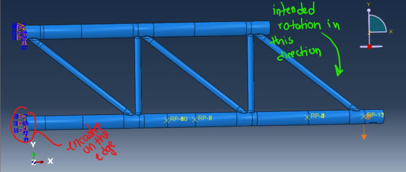

Hello everyone,
So I have a CHS truss that is encastrated in the ending edges and this is defined in the initial step. But in the next step, where I apply a vertical load, I wanted to allow that boundary condition to rotate( I will leave a picture for a better understanding of the movement I want) to simulate a badly encastrated support(where the connecting bolts weren't well "fixed"). Should I deactivate the encastre in the load step and apply a displacement boundary condition there? Or define a different type of condition in the initial step? Should I apply a small rotation in the load step?
What do you think is the best way to approach this?
Thank you so much in advance for all the help.
You can use Displacement/Rotation type of boundary condition instead of Encastre and fix all degrees of freedom in the initial step. Then you will be able to release selected DOFs in subsequent steps.
