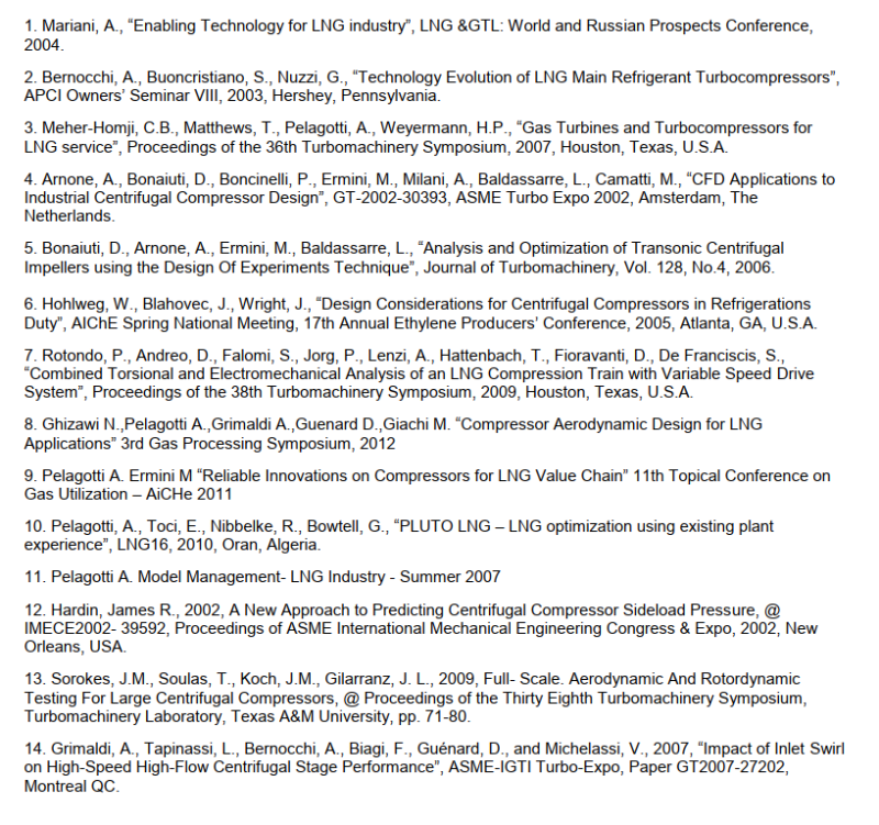

I am looking for a good book explaining the Centrifugal Compressors (Theory, calculations, operation, maintenance, etc).
i am not a designer however, in many occasions i need to calculate some important parameters such as shaft power, polytropic efficiency, discharge pressure,..
I need advice please.
See Google for the book authored by Ludtke - a second hand copy may be cheaper.
For a quick primer, see Perry Chem Engg Handbook. Info here is split between the chapter on "Fluids Transport" and the chapter on Heat Transfer - subsection on refrigeration compressors.
I learned most of what I know on shaft seal configuration and operations related matters from rotating machinery engineers and plant Operations staff - not available in textbooks as far as I know.
