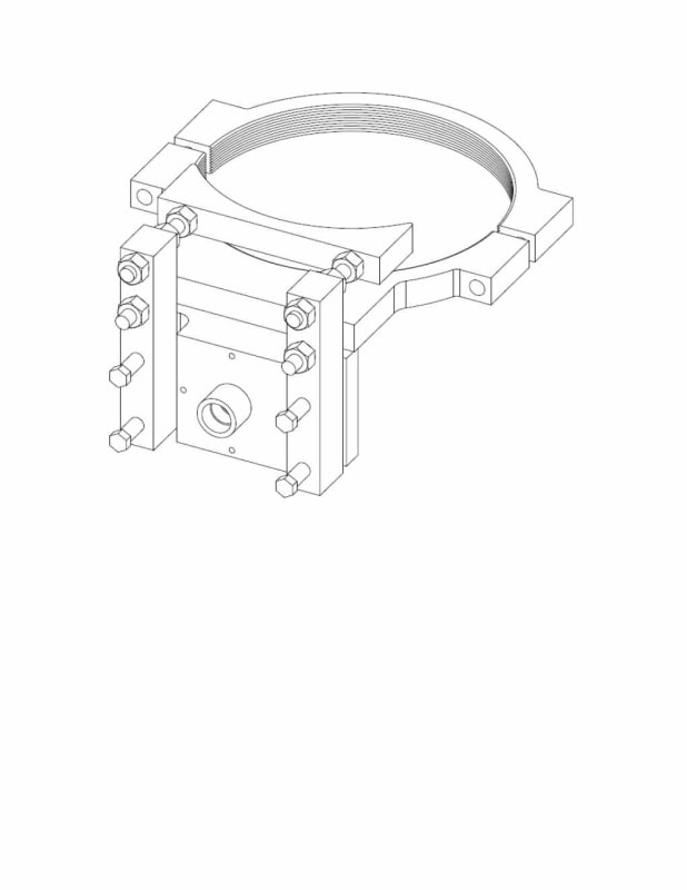

All, thank you for the responses. As requested, the design package from the vendor is attached
We do tend to install clamps common to water service which I do not look into as much. When we purchase an engineered clamp for uncommon circumstances due diligence is needed for me to buy off.
In this case, a 50# steam header had a 1" branch severed at the weld olet. There are obstacles on the back side of the pipe forcing a unique design.
Mechanical Integrity Specialist (Year 1)
What in holy gods name is that thing?
A cantilevered clamp?
I think you're into doing more damage than the original issue here.
Can't you plug the hole from the inside using internal pressure to seal and expanding plug?
This looks like some sort of unholy monstrosity, adding all sorts of forces, moments and huge risk of someone trying to tighten this thing until something snaps.
your original question bears no relevance to this thing IMHO.

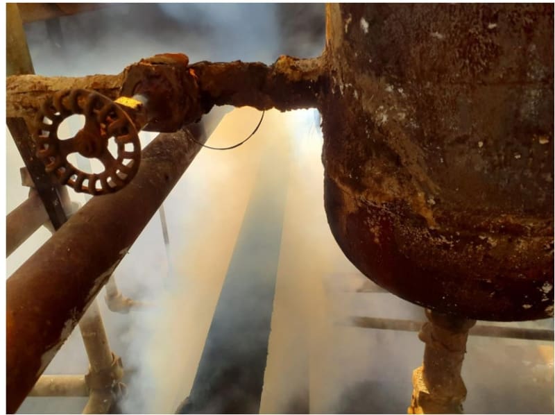

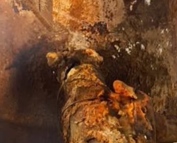

got a photo? We all love looking at pictures of damaged equipment....
Haha! I knew when MintJulep shared google photos I was going to throw you all a curveball.
No, we cannot seal from the inside, and the vendors design these for a living so we have a bit of trust in them to design it correctly... No one here has any design software either so as far as doing some type of stress analysis would be very elementary.
These are photos as close as we could get.

The last time I saw something like that it was evidence photos from an event that killed several people. Time for a new pressure vessel and not for patching this one.
Even the clamp is sketchy - the other end of that teeter-totter could be much farther away, reducing the forces required or just add a second clamp on the other side to split the load in half.
Yeessh.
Well you're a braver man than me trying to fix a clamp to that rusty old pipe.
please tell me you're not doing it whilst steam is p8ssing out of the hole.

If that corroded out "piece of cr@p" is truly your PV, then no good will come of this. It looks like it hasn't been maintained since delivery. Possibly the only thing killing people in the neighbourhood alive now is a "leak before burst" design that would never have envisioned this level of disregard (contempt) for the PV.

Clamping that 24" "vessel" is just a recipe for disaster. I can't work out where that sealing clamp is going and how it will actually seal the leak. Do you want to keep the 1" line operational?
That looks like a might big crack in a very difficult place to seal.
I'm more concerned about the load that balancing clamp has.
you're no reacting (or over-reacting as I am be) about he general corrosion seen. Is this "typical" ?

The clamp is on a 12" steam header and the corroded 1" pipe will be severed and covered. This is not a pressure vessel either strictly pipe.
The corroded piece of crap is 100% the truth for the 1" branch - the 12" steam header has seen 60 years of service with a loss of 0.049". Not a corroded piece of crap...
The seal also will not be a metal-on-metal circumstance and will be filled with sealant rated for the pressure and temperature.
