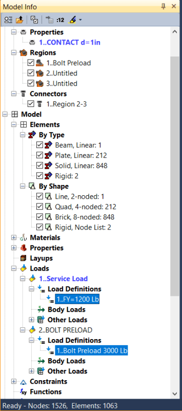

This is the model info tree:

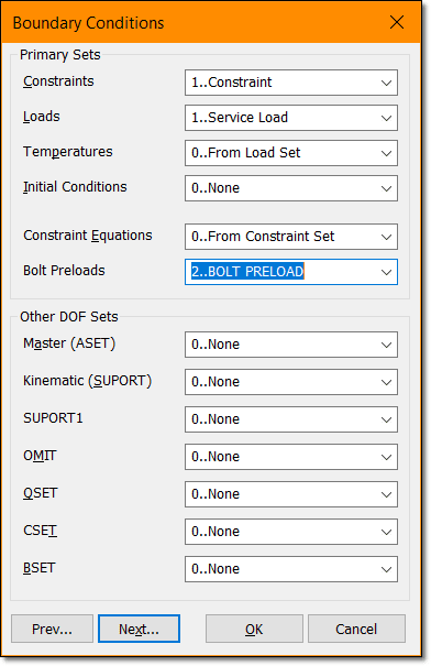

And finally, if you define separate load caseS, ONE the SERVICE LOADS and other the BOLT PRELOAD

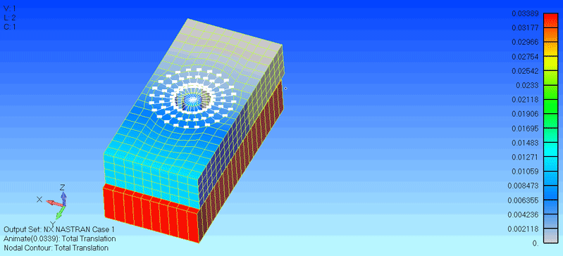

This is the animation of displacement results with bolt preload + service loads:

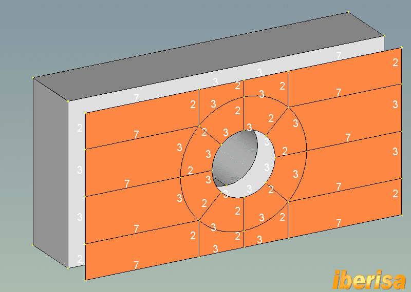

Thank you Blas! Do you think you could quickly show how you created that mesh? I'm not quite able to create such a nice mesh outside of the washer using the mesh by surface command. It seems you are able to use an additional control that I am not aware of.
Hello!,
Is very easy: simply prepare the surface geometry splitting in regular regions and the QUAD mesh will be immediate!.
Next copy the 2-D CQUAD4 mesh to the solid face as PLOT PLANAR, and use it a SEED MESH to generate the HEX mesh using command MESH > SWEEP > ELEMENTS using 5 layers, and finally associate the HEX mesh to the solid automatically and you are done!
