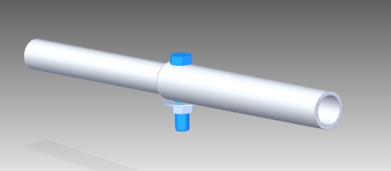

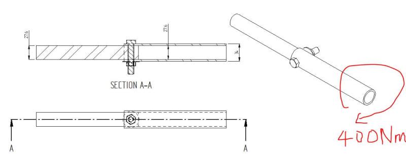

Hello,
I was wondering how to calculate if an M10 bolt can handle 400Nm of torque without shearing if its used to bolt a pipe on to a shaft which is connected to the gearbox?
Please find attached pics for reference.
Thank you so much.
Ross
RN
Hi
Well it will depend on the wall thickness of the tube, I wouldn't recommend doing what you are doing and would say that the tube might fail before the bolt. In addition if the shaft is running at high speed you will have balance problems.
Can you give a more detailed explanation of what you are trying to achieve and we might be able to help further.
The bolt will be in double shear and the tube will possibly fail on bearing strength but without more info we cant really say.
Depending on the application, I see major alignment issues. Show us the whole drive train. Maybe we can suggest a better approach.
