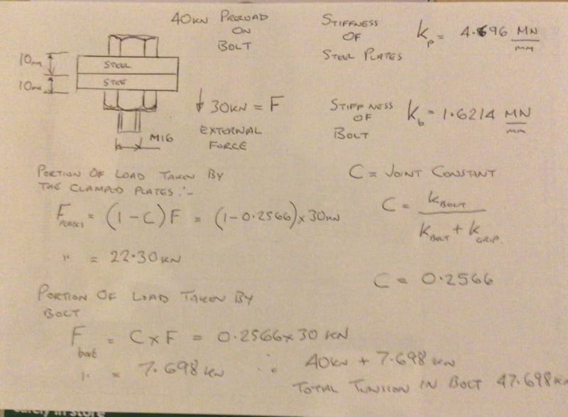

Here you go the bolt tension increases slightly with the external load applied it doesn’t stay constant as quoted by dauwerda
Quote (desertfox)
No dauwerda the bolt tension won't remain the same.
dauwerda said:
Unless you disagree with my answer above, yes it does remain the same.

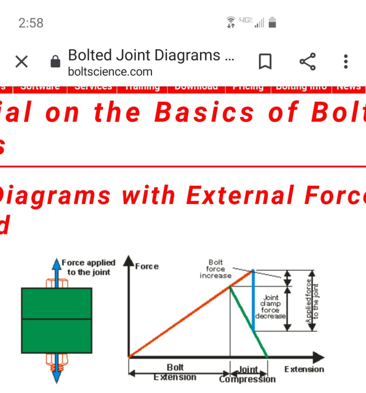

quote from one of the site links below:-
Bolt Load vs Applied Load
The preload elongates the bolt and compresses the clamped parts. When a tensile load is applied to the joint, some portion of the applied load acts to relieve the compression in the clamped parts and the other portion further elongates the bolt. The portion of the applied load that is carried by the bolt is dependent on the relative stiffness of the bolt and the clamped parts. This relative stiffness is known as the joint constant, C:
The following is a representative diagram of bolt load as a function of the applied joint load:
These are the links I used for the calculations:-
This bolt joint diagram may also help.

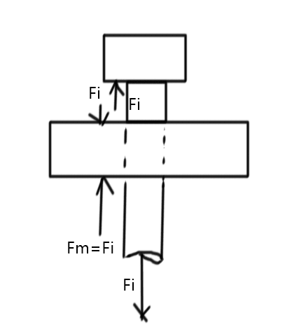

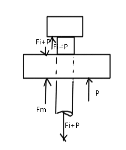

I think the doubt still remains and also there is demand for free body diagram.
So here are a few FBDs with different scenarios.
1. Only Preload
2. With internal load assuming all internal load is taken by bolt (hypothetical)
So the flange load remains same as for only preload case. But this is impossible as bolt has extended due to extra load and there will be flange gap if the flange does not expand.
3. With load sharing between bolt and flange
So the distribution of internal load is nicely defined.
Sorry for long post !

In a real-life case you would need to consider joint stiffness. Looking at the calculation desertfox did:
Preload is F = 40kN
External load P = 30kN
Joint constant C = 0.2566
So, when applying 30kN external load to the bolt, the portion of that load that goes into relieving clamp load / pretension will be (1 – 0.2566) * 30kN = 22.302kN
Therefore the remaining clamp load will be 40 – 22.302 = 17.698kN
The remaining part of the external load is 0.2566 * 30kN = 7.698kN, that will go into increasing the tension in the bolt. As a result, the tension in the bolt will be (as desertfox already showed) T = 47.698 kN.

Hi Nordic8
Below is an extract from one of the links in my post with the calculations, it shows joint seperation to be a criteria for bolted joint failure and gives a formula for working out the seperation force:-
Joint Separation
The knee in the curve in the bolt load diagram above shows the point where the joint separates. At this point, the applied load is sufficient to separate the parts in the joint (all of the compression in the clamped parts has been relieved), and after this point any load applied to the joint is taken entirely by the bolt. The force that will result in separation of the joint is found by:
Fsep = Fpl/(1-C)
where Fsep = seperation force
Fpl = 90% proof load of fastener
Note that the separation force will always be somewhat higher than the preload force.
Separation of the joint is a failure criteria, and a joint should be designed such that it will not separate during service. The factor of safety on separation is found by:-
FSsep = Fsep/Ftapp where Ftapp is the external force applied to the joint.
The only way to increase joint strength is add more bolts or use bigger bolts either way you have to calculate them.

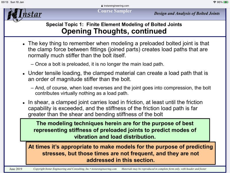

Hi Nordic8
I found this website which might interest you

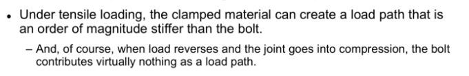

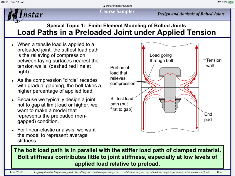

Also I took a snap shot of the last two pages shown below;- it clearly states that once a bolt is preloaded that it is no longer the main load path on the first page and on the second page shows how the major part of the load is transferred through the clamped components, just to clear any further confusion from dauwerda’s incorrect statements.
Please note the words "under tensile loading"...and note the load path (thru tension wall) in the sketch. That's exactly I've pointed out - the tension load is applied to parts connected to the clamping plate, not the bolt.

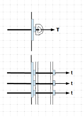

I can think of these two cases below can cause the applied load get directly to the bolt(s). The fittings do not involve in these applications.

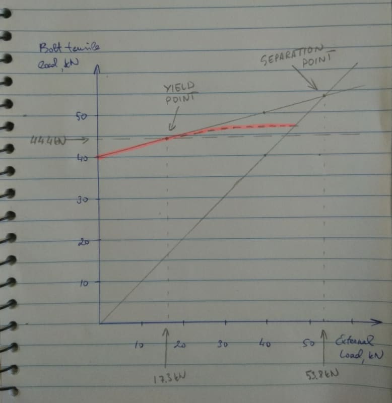

No, I think I got that right. It seems that when external load P is applied, part of it (C * P) goes into relieving clamp force and the rest ((1 - C) * P) will go into increasing the tension in the bolt. This slide from desertfox's link seems to illustrate is as well:
See how the bolt tensile load keeps creeping up as applied tensile load increases - right up to separation point (or if the bolt reaches the yield point - whichever happens first).
It is very interesting, but contrary to my training. I'll keep to investigate, at the meantime, I can give you an example to think about.

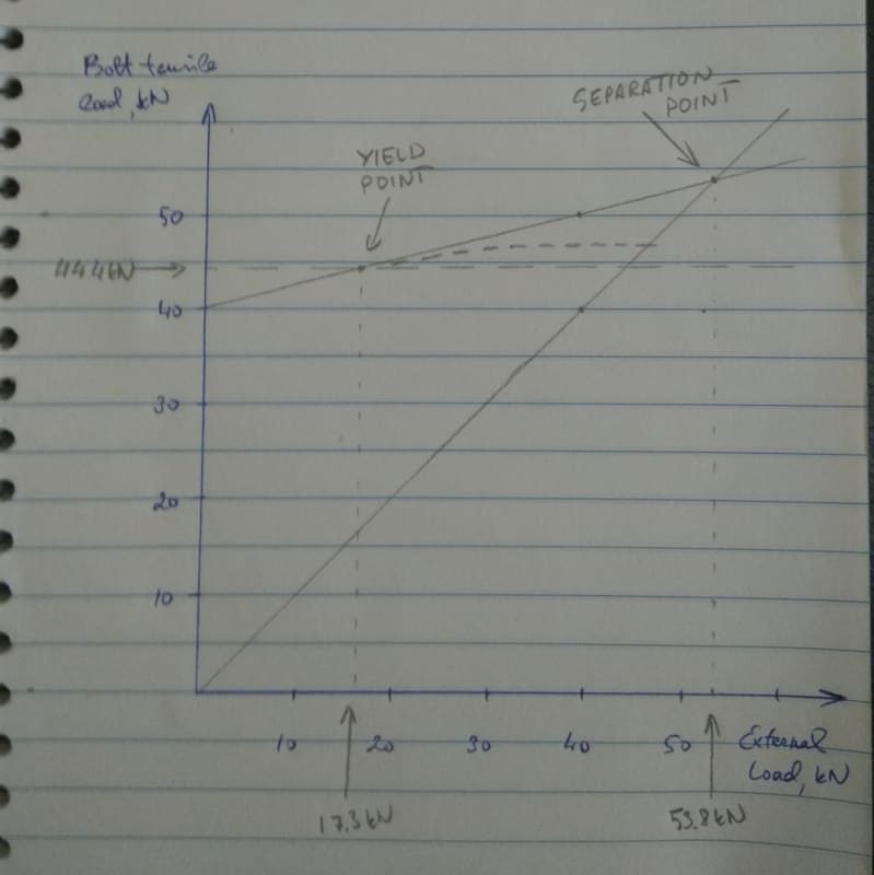

Thanks goutam_freelance and desertfox for those formulas for calculating FOS against joint separation. You've both described the same thing and both of those methods will give the same results.
So, in the example of that bolt with 40 kN pretension and 30 kN external load applied to it:
Separation force (Po, or Fsep) would be Po = Fi / (1 - C) = 40 / (1 - 0.2566) = 53.807 kN
FOS against separation would then be n_o = 53.087 / 30 = 1.794
But how about the capacity of the bolt against yield?
As I calculated earlier, if the bolt is tightened to 90% of it's yield load (as VDI2230 suggests) then the yield point would be reached when external load is 40kN / 90% = 44.444kN

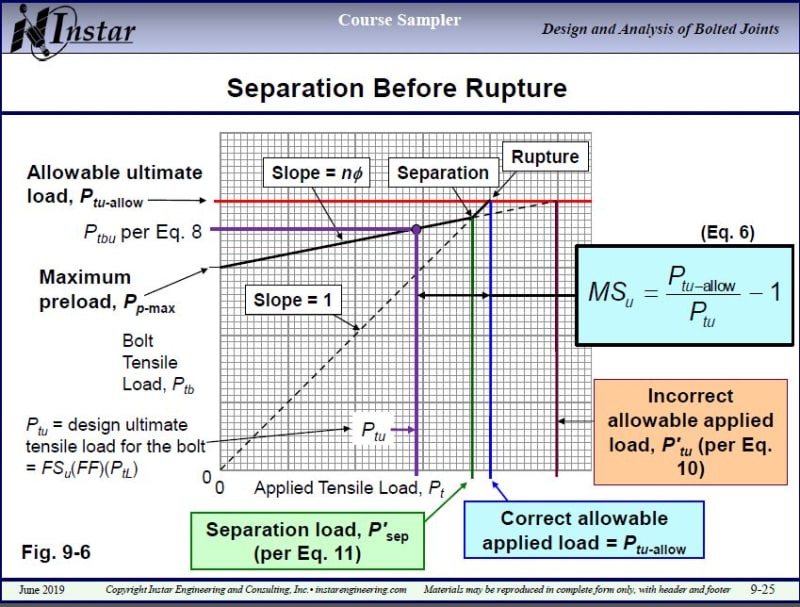

I decided to check how that Applied Load vs Bolt Load graph would look like in this case.
The tension in the bolt equals external load times joint constant: T = P * C. Thats one of the sloped lines on the graph.
The other line is Slope = 1.
The separation point is where those lines cross. The graph seems to confirm my calculations, its somewhere around 53.8 kN
However, the bolt's yield limit is at 44.4 kN... so there's an issue here!
After the external load has exceeded 44.4 kN, the tension inside the bolt will not grow along that straight line anymore, but instead it will go ductile and would probably be more like the curve that I added to the sketch. There would actually be less than 53.8 kN external load required now to separate the joint.
And my drawing also confirms another one of my earlier calculations - the external load that the bolt can take before hitting the yield point is about P_yield = 17.3 kN.
I'm guessing that the situation on those sample graphs that I posted before is more desireable that the situation that I drew up. You don't want the bolts to reach yield point BEFORE separation point, right?
Or actually - does it really matter? It should be alright as far the external force that the joint has been designed to is less than the for that will get it past the yield point: P_design < P_yield
