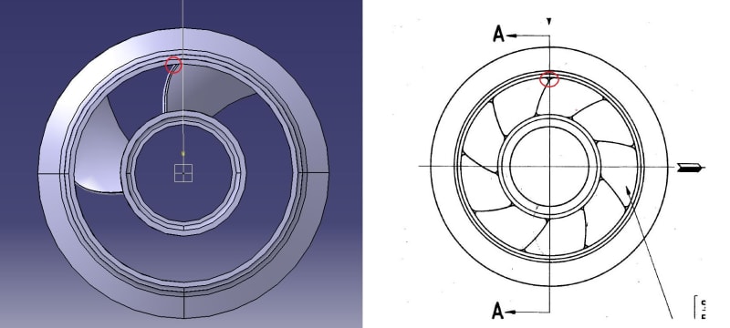

Can someone explain how are these blades defined? I am trying to model them in Catia but I am not sure what "lead" 6.000 RH" actually means and and where is the centre of helix twist.
Never seen this kind of dwg before (old dwg) so not sure if everything is defined here or there is some missing info...
I would presume that the 6.000 is a pitch, similar to a thread call out.

"lead" of a helix is how far the helix advances in one revolution, in this case 6.000 inches. So think of a radial line sweeping a helix, advancing (use the RH rule to figure out which direction the vane advances) on the central axis at 6.000 in/rev. Then the vane gets trimmed by two conical surfaces .720 in. apart. Now copy the vane formed 9 times equally spaced around the central axis.
What about position of helix centerline on the side view? I presumed its .440in or am I missing something?
"Developed form of vane in direction of arrow X" confuses the hell out of me.
Section A-A cuts through two vanes, yet vanes are not shown with a hatch in (what seems to be) the section A-A view.

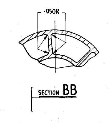

There is a section line B-B. Where is the B-B view?
One edge of each vane seems to be curved, but I don't see anything that defines the curvature.
The other edge doesn't seem to be shown.
It would help me if the direction of rotation or direction of flow were shown. Then I could make a better guess as to which way the vanes pitch.
B-B just shows fillets between blade and inner/outer walls...
Like Ed said I presumed its a thread callout and modeled it like helix with a 6in pitch. Position of a helix centerline is .440in dimension. This gives the closest result to the drawing but as you can see in image, the curvature of leading edge is not the same and point on leading edge tip doesnt end up on SECTION A-A line (part centerline) like in dwg...

The end view showing curvature of the blades is due to the blade being truncated/trimmed by a conical surface. Do you see the 27 degree conical callout that defines the leading/trailing edges of the vanes?
Maybe you have modelled the 27 deg. conical trim already, and as you say, the curvature in the end view looks different - which view does the actual impeller most resemble, the drawing or your CAD model?

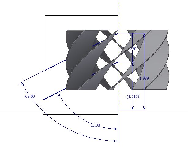

To show what I mean, with visuals generated in my 3d solid modelling program:

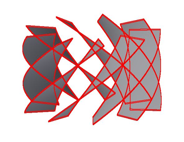

Here is an image of 9 developed screw flights: a horizontal rectangular shape swept through about 1/4 revolution on a 6.000 pitch helical path, and then circular patterned 9 times.
Next, I trimmed those flights with two triangular sections, making revolved cuts around the helix centerline, at 27 degrees to horizontal, or 63 degrees relative to the rotation axis of the helix, using the sketch shown below:

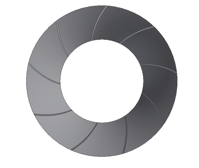

The result looks pretty close to what is shown in the drawings, see the end view of the trimmed impeller below (I have not modeled the i.d. and o.d. cylindrical surfaces nor the end conical flare):
It probably needs to be tweaked to get the vane section to the correct thickness. There will likely also be issues with how the "blend radii" at the i.d. and o.d. walls is accomplished in CAD, but then that's always the way it seems. Also, I didn't address Mint's concern about the side view of the developed vane, but would assume a horizontal section cut through a single vane would create a view similar to the drawing...or maybe not. Either way, I've wasted enough time and have other things to do now, and already deleted the cad file.
btrueblood thank you for the effort. I did the trim already and the actual impeller resembles drawing more than my 3D model but I am trying and tweaking it bit by bit with center of helix position etc. Unfortunately this is all playing and not really exact science as it should be :D
