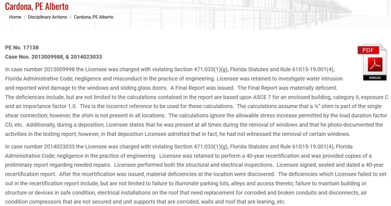

And incidentally, people in Florida have gotten spanked for that approach that AWC advocates, where they then find a "defect". (It's not "clean" in that disciplinary ruling, because there were a number of misrepresentations in the report as well, however. The guy got in trouble for evaluating a window based on the current wind load (and missing a duration of load), calling it defective, claiming to have witnessed three window disassemblies (actually saw one), and didn't run the calculations based on the code in force at the time of original construction.
