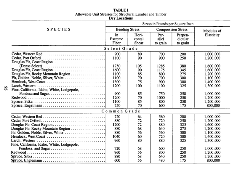

I'm interested in getting people's thoughts on the strength of existing wood joists in an existing building built in 1909. My scope was related to evaluating the roof framing for new RTUs and the 2nd and 3rd floors for some new mechanicals, but we came across an issue where I ended up evaluating the existing joists. The building is 32' wide x 155' long. The joists on the 2nd and 3rd floor span from front to back between 15'9" and 17' (span lengths), between steel beams. The building was renovated in 2007 and the drawings from that renovation list the LL as 100 psf and the joists as 1.75"x13". I performed a check on these joists and they were not working for a Fb of 1,000psi. I informed my client and they were not happy. In fact, they found another engineer to run some numbers and see if it works to verify my opinions. A calc I received from a supposedly licensed engineer uses a Fb of 1750psi for Douglas Fir Larch #1, with a repetitive use factor included. I feel like this is somewhat unconservative, but the drawings from 2008 also listed these joists for 100 psf LL capacity. I wanted to get people's thoughts on using 1500 psi for existing wood rough sawn joists. I've included some photos. They are not happy with me and my findings and I've been asked to sharpen my pencil, but I'm not sure how far I want to go. Reinforcing all the joists would be a serious undertaking of costs and time, but I can't let that dictate my decision.
Where is the building roughly located? This will make a difference with the type of wood used in your locale.
The building is in Chicago. I can get the joists to work using a Fb of 1200psi and use of repetitive member factor.
I'm kind of amazed when these questions come up. There's so much information available out on the internet. I personally have pdfs of the UBC going back from 1994 to 1927 where the max for Dense Select DF Coastal Region is 1750 psi so the "supposedly licensed" engineer may be right you will need to determine the grading yourself. However, you don't just blindly apply that allowable to the current code method for designing wood you will need to read the standard from the time and determine what reductions/increases you can take per that standard. Apples to apples.

I've talked to AWC directly about this years ago and they said very clearly that if you are checking something to modern standards you should be using modern design values. There are no adjustment factors in the NDS so the current standards must be followed. Unless you are getting the wood tested, you have to use the current code values.
That's interesting jerseyshore..I've mostly read about going back at determining design values based on the time it was installed. In this case for example, E is 1.8 in 2018 NDS for DFL, but it is 1.6 for select structural DFL in 1927 UBC. I have read through many codes and understand that 1750psi is the allowable for DFL, but this calculation was performed without a site visit and knowing the wood type. In our area DFL was prevalent in the early 1900s, so that's what I'm assuming it is. It's just a matter of choosing a design value. Even for DF, there are several different design values for select structural see table below from 1927 UBC, which I believe is a good representation of the 1909 wood building we have here. I did a lot of research and didn't find much regarding wood strengths in early 1900s. Since this building will be used as a public place (restaurant/night club), I would prefer to be conservative. I may go out to the building and ask the ceiling finish to be remove to inspect the ceiling joists. If I sand a bit off the surface and see the grain is tight and doesn't exhibit a lot of knots, I'd feel comfortable using a select structural. Select structural DFL in 2018 NDS is 1500 psi.

I do a lot of historic buildings, and I do not just use the modern design values (though I do use them as a starting point). A few reasons:
1) We're mostly southern pine around here, and that species group changed about 10 years ago and they downgraded the allowable stress values. Anything put in before 2013, I bump it up a grade and/or use the values from before the change (depends on whether I'm using software with preset materials or doing it by hand - the error is less than 2% if I remember correctly).
2) Applying current design values to existing displays a misunderstanding of where those values come from and why they are what they are. For some good reading on how these are developed, check out these sources: TFEC Tech Bulletin 2018-11, The Wood Handbook (Chapter 7), ASTM D2555, and ASTM D245. These values are conservatively low because wood is a terrible material for structures. I don't really mean that, but I also do. I guess I should clarify by saying it's terrible for engineered structures. It's not clean and tidy like steel. It can be manipulated and formed like concrete. It is a natural and highly variable material. Reference design values are set at the 5th percentile - roughly 95% of all visually graded lumber used will be slightly to significantly stronger than we give it credit for. But until it's used, we don't know. To quote a recent Structure Magazine article:
Evaluation of Existing Timber Structures | By: Jim DeStafano said:
The National Design Specification for Wood Construction (NDS) is a reliable standard for the structural design of new timber structures but is not a good standard for predicting the actual behavior or adequacy of existing structures. Within timber grade classifications, there is a wide variation in strength properties. The published allowable stress values are calculated based on the weakest 5% of timbers of a given species and grade. Consequently, the published reference design values are very conservative for most of the timbers that are in service.
I've mentioned this before and maybe somebody has reposted it, but I can't ever find it: there's a Canadian code about evaluation of existing buildings that gives guidance for adjusting design values based on time in service. I think I first saw it from KootK. Or maybe jayrod? The idea is that if a structure has been in service for a long period of time and has not failed even though our calcs say it 'should have' it's probably stronger than those values give it credit for. In the commentary for ASCE Chapter 4, they give "Typical Live Load Statistics." If the building is older than the reference period for the class of structure, I feel comfortable saying it can support the previously applied load at least. The Existing Building Code bears this out as it allows you to continue using a structure for the same or even slightly higher loading as long as the structure is not damaged.
3) Trees today are not the same as trees growing 150 years ago. Today, we've exhausted the commercially available stocks of old growth trees. The ancient trees that stood for a couple hundred years, growing through the mini-ice age with super tight growth rings and the sort of density that make it impossible to reproduce a Stradivarius: we cut them down and built stuff. And that wood is pretty amazing. Today, we grow it on tree farms as quickly as possible in warmer conditions that result in less dense wood. The wood itself is the same, but the density is different and the grain spacing is different. The result is lumber that isn't as strong. So depending on the age of the structure, the current reference design values may be far enough off that they don't really apply.
That's not to say wood gets better with age. It doesn't. It typically becomes more brittle and less ductile. It'll be more prone to splitting. And if it is overloaded, it'll be more susceptible to a rupture type failure than a 'younger' piece of wood.
A word of caution: don't just look at older books to get design values, either. In some cases they may not be compatible with our current methods of developing allowable stresses (which are still generally valid, but need minor modification to capture actual behavior). They also may be wrong. For instance, there was a general misunderstanding about tension capacity of wood for a long time. Up until the 50s or 60s we just assumed allowable tension stress would equal flexural tension stress. That didn't change because wood changed, it changed because we (the engineering community) realized we were wrong. So look at them, but also do some research to understand why and how they arrived at those values. Using them may not meet the requirements of the code, but then again it might.

Data point fwiw - 1899 nyc building code, "Safe extreme fibre stress in bending" - Yellow pine = 1,200, oak = 1,000, spruce = 800

Just to follow up regarding what I said above, here was the quote I got back from AWC on this topic after they discussed it during a webinar:
"When checking something to modern standards, you should use the modern design values. The standards and design values are developed in conjunction with each other, and changes over the years have impacted both. The new values do reflect that there is more juvenile wood in the supply chain than in the past, as well as the refinement of various test standards, amongst other things that have impacted design values over the years. There’s really not one particular thing you can point to as the main driver of the changes in design values. I don’t know that there’d be a consistent adjustment factor, and there isn’t one in the NDS. In general it’s best to follow the standard whenever applicable."
For me this was the end of using the old Fb of 1250 psi for the older DF#2 we were running calcs on (most common lumber around here). Current NDS says use 950, I use 950. Unless I get it checked or tested (which is ultra-rare), I'm not going against AWC. They write the code, not me. And if something happens I don't want to be the guy going against the code.
