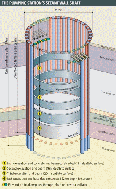

hemiv - Put the ring beams as low as possible, for two reasons:
1) Chance of misalignment is greatest at the bottom (most distant from the drilling rig)
2) Pressure is the highest. If there are going to be "problems", they will occur at or near the bottom.
Here are two illustrations of different projects, from the web, that demonstrate putting ring beams low. One is the example I linked to:
