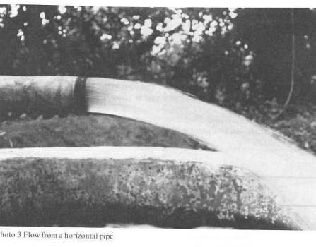

"But if this is true, how does one actually calculate if an entire section of pipe (not just the discharge point) is partially full or completely full? Seems like it ought to be a basic calculation."
Well try looking through the book I posted that gives you that length in the figure 9.9 above.
I'm with Katmar here - it appears as if this equation only really relates to the end section when discharging to the open air / above a liquid level.
It doesn't seem to try and calculate the length from the end to where the pipe is actually full and for other parts of the system seems to result in quite a high velocity which would normally be seen as being able to blow out any air int he system and result in a full pipe.
This is the length referred to in diagram 9.9 above.
For truly horizontal pipes you are correct in thinking that for any reasonable flow rate the length back from the open end cannot be infinite as partially filled pipe because otherwise there is no driving force ( head / pressure). As soon as the required head to flow your flow in an semi open pipe exceeds the ID of the pipe then that implies that the pipe is full at that point. It is complicate dby the fact that as the pipe fills up the velocity changes. If you look at diagram 9.9 you can see that the slope of the liquid level changes and becomes flatter in the middle.
The full pipe velocity in the example page listed that you posted turns out to be about 0.8m/sec (for a full pipe). I find it difficult to believe that a long pipe could flow that fast without being full.
So your second point - can this be for an entire network - yes if the flow is low enough. The driving force is simply the head of water in the pipe at the entry point is higher than it is at the exit point. So for say a 6 inch pipe, if the depth of water at the entry point is say 5 inches above invert level, but at the exit point say 25m away, it's 2 inches above invert level, hence flow in a partially full pipe, but must be really quite low.
I think though you are extending this < or > 10.2 equation away from where it is valid ( the end of the pipe where it exits to free air) to the entire network where it isn't valid.

The key section to me is the phrase "...at the end of the horizontal run...", so is focused primarily, as far as I can see, on whether as the fluid exits the pipe, is it a full pipe or a partial pipe.
Doesn't seem to go into how far back you get any transition from full pipe to partially full pipe.
Also " At the flowrate represented by this value [the 10.2 number ] a horizontal pipe will be sealed at its end by the flow of liquid in the pipe" - my emphasis.
So for flow in the rest of the system I can't see the value of this number, but is useful to note that the last section of pipe pressure drop would be different to the fully filled pipe.

To me, the usefulness is as a method to check that the piping discharge runs full at steady state. If you find that your discharges aren't sealed then you have to re-evaluate the design - be either full flow or partial flow always, as bimr pointed out.
Well to estimate the length based on that diagram 9.9 I would calculate the pipe full head loss for your flow rate, figure out or estimate what the depth of the liquid is at the end and then extrapolate back until you hit the top of the pipe. Or just ignore the depth and use the pipe invert. The real point will be somewhere between the two.
At the least it will be a start point for any calculations and you can see if that amount of partial flow pipe is significant it he grand scheme of things. So if you calculate that and it's 5m, but your pipe is 50m long then I would just ignore it. if is 15m and your pipe is 20m long different story.
