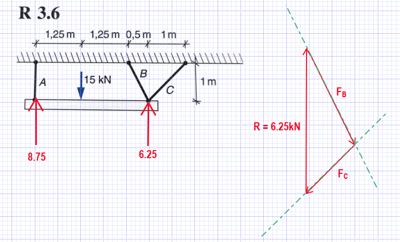

I'm trying to refresh my knowledge from my BSc mechanical engineering degree 4 years ago and this specific structural frame problem has me stuck. There must be some basic line of thinking I've forgot.
Task: Find forces in A, B and C.
I start by making a free body diagram, and split B and C forces in their X and Y components.
I find force A by calculating the net moment on intersection between B and C: Force A = 8,75kN.
Net force in Y-direction gives Fby+Fcy= 6,25kN.
Net force in X-direction gives Fbx = Fcx
From here on I'm stuck...
(Final answers are: FA=6,25kN 8,75kN, FB=4,66kN, FC=2,95kN)
Edit: FA=6,25kN 8,75kN
Edit2: Solution found. The basic line of thinking I forgot to use was trigonometric substitution in the equilibrium equations..:)
Assuming those are pinned connections truss members.....I solved by first taking the moments about the point where the two truss members meet (to get FA), then I summed forces in the Fy and Fx directions and solved simultaneous to get the answers. (Not the same as you got in the last line of your post.)
[red]EDIT[/red]: With your updated post, our answers match.
You're on the right track. The force in A of 8,75kN is correct (although you did write 6.25kN as the final answer), and the two equations you have are also correct. You just need to come up with the additional equations by accounting for the angle of B and C. This will allow you to relate Fby to Fbx and Fcy to Fcx then you can solve the equations you have. You can then determine Fb and Fc since you'll know the vertical and horizontal components. Hope this helps!

The beam is supported by a roller support at the left and a pin support at the right. The reactions are 8.75kN at the left and 6.25kN at the right.
FA is 8.75kN by inspection. FB and FC are the forces which produce 6.25kN vertical, which can be found graphically (see below). The force in members B and C can be found using trigonometry, but if the reaction force is drawn to scale, they can also be scaled with sufficient precision for most purposes.

WARose: How do you combine them whem solving simultaneous? I've written what I found with net sum X and Y directions. Did you use trigonometry to combine the equations into one another?
ProgrammingPE: I'm trying this right now. I'll come back with what I find.
BAretired: Have you also found B and C forces individually? I agree the vertical is 6,25kN
Just added them together. I first multiplied the Fx set of equations by -1. That enabled me to eliminate the Fc term and solve for FB. The rest is pretty straight forward.
No, I haven't done that, but I drew the stress diagram to scale, so I would estimate Fb to be about 4.8kN and Fc to be about 3.1kN.

Hi all,
ProgrammingPE:
I've managed to solve this problem now. FB=4,66kN and FC=2,95kN by using the X and Y net force equations:
Net force in Y-direction gives Fby+Fcy= 6,25kN. (Eq. I)
Net force in X-direction gives Fbx = Fcx (Eq. II)
And using some basic trigonometry: Substitue both terms in Eq. I with their Fbx terms by trigonometry. (Fby=Fbx/tan(26,57)=Fbx/0,5 and Fcy=Fcx/tan45=Fcx/1=Fcx).
Solve to find Fbx, and then find the rest with vector sums and trigonometry.. Thank you!

When I scale dimensions, I tend to err on the safe side. Looking at the stress diagram from my previous post, it is clear that:
1. FB*cosθ + FC/√2 = 6.25 where θ = tan-10.5 = 26.565o
2. FB*sinθ = FC/√2
Solving these two simultaneous equations, I get 4.66 and 2.94 for Fb and Fc respectively.

The third equilibrium equation is the sum of moments = 0. That was used in determining beam reactions, but is not needed to determine bar forces which meet at a pin joint where the moment is known to be zero.

I see. So basically you use the ΣFY and ΣFX equations, but substitute the Y and X force components for B and C with their hypotenuse equations, and skip using trigonometry since we know all 3 sides of the triangle, and the forces through the objects act like pin-jointed trusses (forces only moving parallel through the objects).
Thank you, now I understand. I was starting to wonder if you solved this without exploiting geometry math:)
