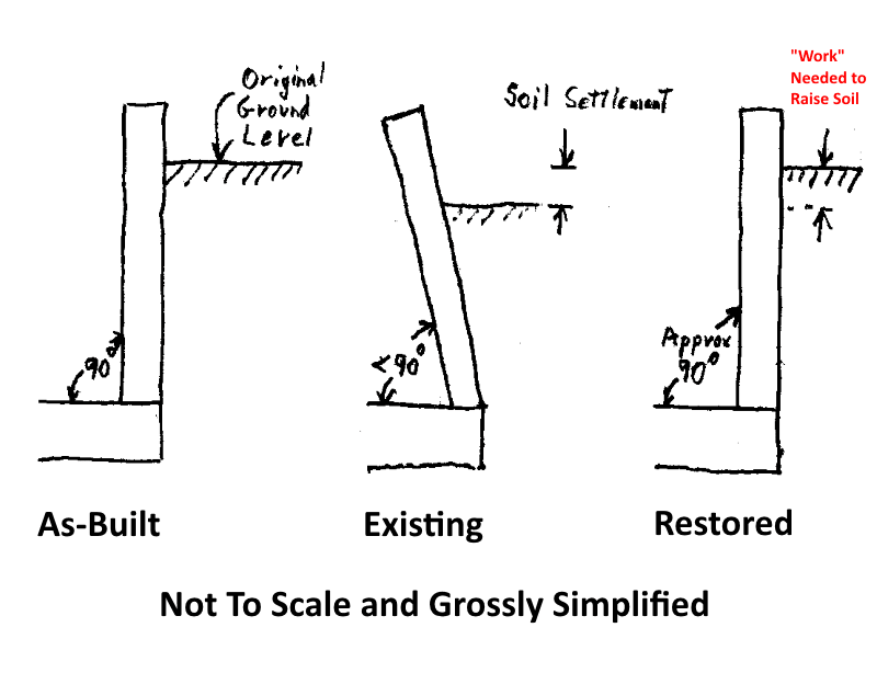

Hi all, I'm working on a little project to stabilize and push back my bowing basement wall. Going to go with an I-beam at 4-5' centers, with an angle foot plate anchored to the basement slab and an angle top piece connected to my joists. I'll have a bolt going through the top angle to apply pressure to the beam during dry seasons and hopefully slowly bring the wall back somewhat plumb. (Like this
What kind of loads should this system be designed for?
I need to bring the wall in almost an inch, so for a 7' basement wall that's about 1.1%, so I took a look at at-rest pressures.
Say, Ko=0.8
unit weight=125pcf
c=800psf (not sure about this one)
Then, the horizontal earth pressures I need to overcome are: 0.8*(7'*125pcf)/2 + 2*800psf*sqrt(0.8) = 1781psf at the bottom of the wall. Top of the wall would be 1431psf.
Say 5' tributary width on a simple span, and I end up with a required moment of 44.5 k-ft, requiring a Zx=10.7in3 or 17.8in3 with the ASD factor. End reactions are 25.5k. The modulus is not as surprising to me as the end reactions. Most systems I've seen are not sizing their connections anywhere near enough for that kind of load. Seems to be mostly done with (2) 1/2" concrete screws, and done in a 4-6" slab. So I figure I must be off somewhere.

hemiv said:
I am still interested in hearing from someone whether or not, or to what degree, these loads are time dependent. i.e, Seems to me it would take much more force to move them in, say, one day than in, say, 2-5 years.
The force needed to restore the wall to near vertical is not time dependent. This is because the problem is more than soil mechanics, see my sketch below.
1) As the wall bows inward, soil outside the wall both settles (under gravity) and self-compacts.
2) For the existing condition, soil level outside the wall is generally "lower" than it was when the wall was constructed.
3) To "restore" the wall to near vertical, the applied horizontal pressure has to both overcome soil resistance and "do work" (in a mechanical engineering sense) to raise the overall soil level outside the wall.
Note: Yes, the soil may slowly compact somewhat from the applied horizontal force but basically it's volume remains unchanged and the only way for it to move is "UP".
Until the magnitude of the applied force is adequate to both overcome soil resistance and "do work" (raise the outside soil level), not much (other than maybe some soil compaction) is going to happen... no matter how much time passes. Gravity never takes a day off.

It is seldom that I disagree with Slide Rule Era. First of all it is an unreinforced block wall. Has no real bending resistance and depends on the load from above to keep it together when loaded sideways.
The top is pretty much held from moving since it is loaded with a flooring system of joists AND FLOORING AND WALLS ON IT. That makes it a solid mass, not likely to distort horizntally in the middle, since the whole house, more or less is resisting the push. So the basement wall can't take its load from expanding soil that and the mid height zone bows some inward, LEAVING THE TOP UNMOVED.
Also if it was a reinforced concrete wall and was being shoved outward, the stuff that settled won't go back up as shown when pushed from inside. Instead there will be a whole mass sliding on an outside inclined slippage plane. This all assumes the earth outside is incompressible, most unlikely. I'd flag it and ask that it be removed.

SRE makes an EXCELLENT point that I had not even considered, which greatly increases the force required to restore the wall to vertical.
