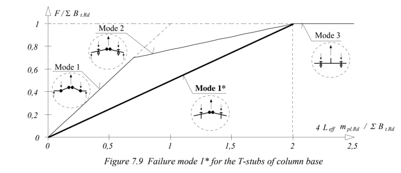

Sammy, DG1 & 16 are fairly old methods these days, there is a lot more recent advice coming out of the UK and Europe. They use yield line theory looking at multiple patterns taking the most critical pattern, converting it to an equivalent T stub of Leff length. Leff is equivalent to Y. DG16 just looks at a single pattern which may or may not be the critical one.
Check out SCI guidance in P398, this is considered more state of the art and is codified in eurocodes.
Nothing wrong with DG16 methods as long as you stick to the limitations on setout. P398 will allow you far more flexibility to assess configurations that won't conform to DG16 configurations including baseplates (there's an entire section on this).
The reason they don't check prying on baseplates is that the concrete in bearing out on the edge of the plate often will crush.
See screenshot below, they are basically saying we aren't sure if we can rely on the prying. Therefore let's assume a straight response called mode 1/2 (just cantilever action, no prying) to the start of mode 3 (which is failure in the bolts) in European nomenclature.
Edit - screenshot from "Design Of Structural Connections To Eurocode 3 - Frequently Asked Questions"
