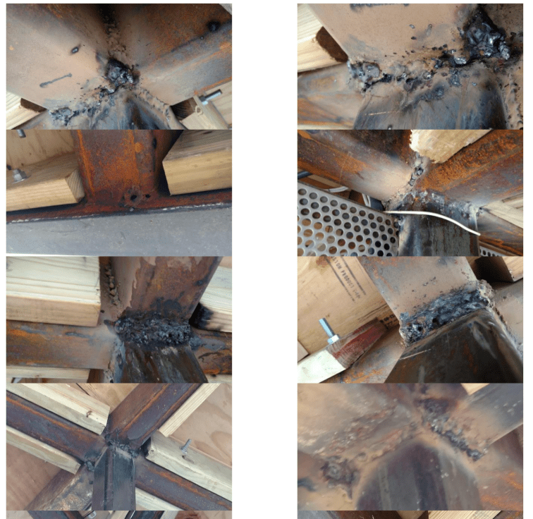

For your viewing pleasure. Caught by third party inspector.

As bad as that weld is they didn't burn the wood structure down so that's a plus right.
Can I get the name of the inspection company, over here on the east coast I don't think any of the crew we get doing inspections on jobs would have given this a second thought.

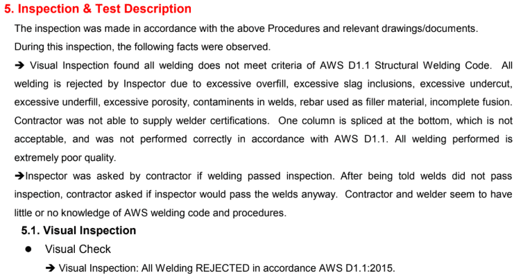

ha. I like that the contractor asked if the inspector could pass it anyway. Inspector proceeds to put that request into writing.

I fault the inspector. He (she) is too darned nice. One sentence should have been enough. "All field welding type work is rejected."
I suspect the timber was added afterwards. Due to the limited access and observed weld quality, this might not be true however. But given how close the timber is to the weld I think it would be an issue and you'd see some effect on the timber from the heat.
This project is located in Austin, Texas. It is cheaper and commonplace in this area for steel HSS tube frames like this to be field cut and welded. The overall quality of construction in Austin is very high and work is frequently inspected and tested so issues like this is very rare.
It looks like the contractor added the entire roof wood framing before getting the welds inspected, not good...
The inspector was "Justin's Welding", a small local firm.
Shortly after the report was released the contractor called our office asking to pass the welds..

No only one blind man but builder also. My bet those hollow sections not designed as to capacity, no weld sized right either..
