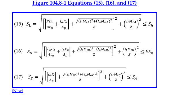

B31.1 2020. Stress Calculations 1
KevinNZ
Jun 12, 2003
871
NZ
B31.1 2020 is changing how pipe stress is calculated. Stress intensification factors will be applied in three axis and tension/compressive forces will be included.
Also note, while Appendix D is still in the code, all references to Appendix D have been replaced with B31J.
