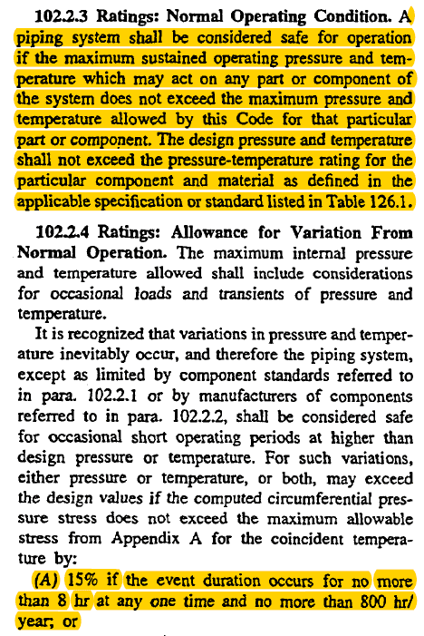

104.7.2(c): Proof Test shall be made in accordance with ASME B16.9;MSS SP-97 OR Section I A-22. You have to follow the requirements as they appears in one of these Standards
Did you read 102.2.4 in that it allows B16.5 flanges to be used beyond their rating?
Again, I’m not overly familiar with B31.1, but that’s something I’ve never heard before. That’s probably not written in that paragraph.
To provide an answer to your original question, and let’s say B31.1 allows B16.5 flanges you be used above theIt rating; afaik there’s no similarity in EN 13480.

Hi Huub
I have attached an image below abstract from the clause.

Refer to 104.7.2, you have 4 options, proof test is one of them.
104.7.2(a) - Based on service experience.
104.7.2(b) or 104.7.2(d) - stress analysis based on ASME BPVC VIII-2.
Consider to use one of the options above, before you going to destroy an item.
