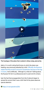

There is a video. It appears to have lost attitude control. There are also videos of the tail section full of holes as of it were impacted by shrapnel, both entry and edit holes. If the videos are real, and they appear in my eyes to be, this was a shoot down.
The long video of the crash is here:
Here is the shrapnel damage.

None of the holes have been shown to penetrate both sides of the tail elements, suggesting they were caused by low velocity projectiles, like rocks kicked up from the crash landing. The holes show a directionality pattern, consistent with ground debris kicked up and impacting the plane during the crash as shown in the video of the crash.

IR, see my first post. All of the holes penetrated both sides.

There are entrance holes on one side of the stabilizer and exit holes on the other. The access door to the unpressurized tail section was open before the crash. There were holes in the cabin and at least one inflatable life vest recorded by a passenger prior to collision with the ground.

If none of the holes are 'through and through, it should be real simple to determine what made them. It would have to be a real slow projectile to not penetrate both sides... I suspect not likely a bullet. I would suggest that a bullet would have a fairly distinctive penetration.
Well according to the SBU the plane was shot down by a Pantsir-S1 system they also showed a picture of what remained of a 57E missile on a shoreline (not sure this picture is from this incident though it doesn't say).
However I doubt that, that was what hit the plane, simply because the injures on the plane doesn't correlate with this type of missile that have high explosive multiple continuous-rod/fragmentation warhead working like this.
The plane would probably not have survived that if it was used.
However the Pantsir-S1 also have two dual 2A38M 30 mm (1.2 in) autocannon guns with 700 rounds in a variety of ammunition,
HE (High Explosive) fragmentation, fragmentation tracer, and armour-piercing with tracer with a range up to 4 km.
It is more likely this was used, seems to fit better with the damages on the plane too.
