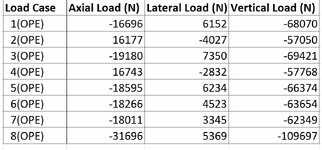

Thanks for your response. See attached loads provided for one of the supports. Loadcase 8 is a hydrotest load case.
Loadcase 1 - Weight of pipe including content and insulation + Maximum Design Temp
Loadcase 2 - Weight of pipe including content and insulation + Maximum Operating Temp
Loadcase 3 - Weight of pipe including content and insulation + Maximum Design Temp + Internal Design Pressure
Loadcase 4 - Weight of pipe including content and insulation + Maximum Operating Temp + Internal Design Pressure
Loadcase 5 - Weight of pipe including content and insulation + Minimum Design Temp + Internal Design Pressure
Loadcase 6 - Weight of pipe including content and insulation + Maximum Winter Temp + Internal Design Pressure
Loadcase 7 - Weight of pipe including content and insulation + Internal Design Pressure
Loadcase 8 - Weight of pipe including content and insulation + Hydrotest Pressure
That looks about right. It assumes you have some sort of movement in all cases, either thermal or contra tion from Poissons effect and a simple sliding support steel on steel so friction factor 0.3.
If this supports are simply set on grade then they will overturn if you get any significant movement.
Ask the team to also give you axial movement at each support.
If it's only say 5mm then the sort is fine. If its 25mm then maybe not.

The sleeper you show is just a sliding support. The only horizontal force is due to sliding friction when pipe thermally expands. The maximum horizontal friction load can only be the coefficient of friction times the vertical weight load of the pipe. For steel on steel (pipe on steel plate) the coefficient of friction is 0.3.
Fh = 0.3 x Fv Where Fh is the vector resultant of the axial and perpendicular horizontal loads and Fv is the vertical weight load of the piping on the support.
If your horizontal load is greater than 0.3 times your vertical load then there is a mistake somewhere.
For large horizontal friction loads typically spread footings are used sized so that the overturning moment due to friction is opposed by the resisting overturning moment of the footing.
I just saw that you had posted loads from piping stress report. Those look about right as the vector sum of horizontal forces is about 0.3 times the vertical load indicating the horizontal load is basically due to sliding friction.
In this case use spread footings designed to have an overturning resisting moment greater than the moment due to horizontal friction load.
As previously indicated use teflon pads to reduce horizontal load by 1/3. Teflon has coefficient of friction of 0.1.
