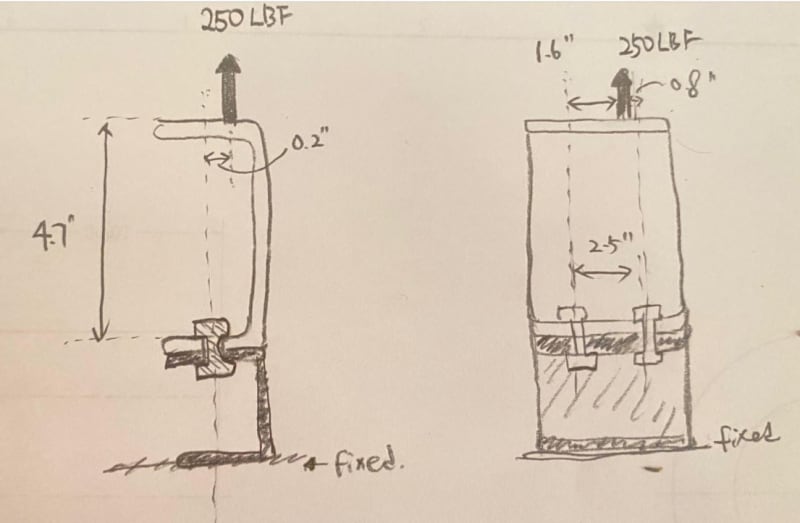

Hello
Could anyone help me with finding out the axial load on the bolts?
Thank you
Have you made any effort on your own? If so, what did you come up with?
It is an indeterminate problem without the properties of the channels.
BA
You don't need to worry about the force in the bolts, as they are far more rigid than the flanges of the channel, which will experience a considerable amount of stress due to prying action.
